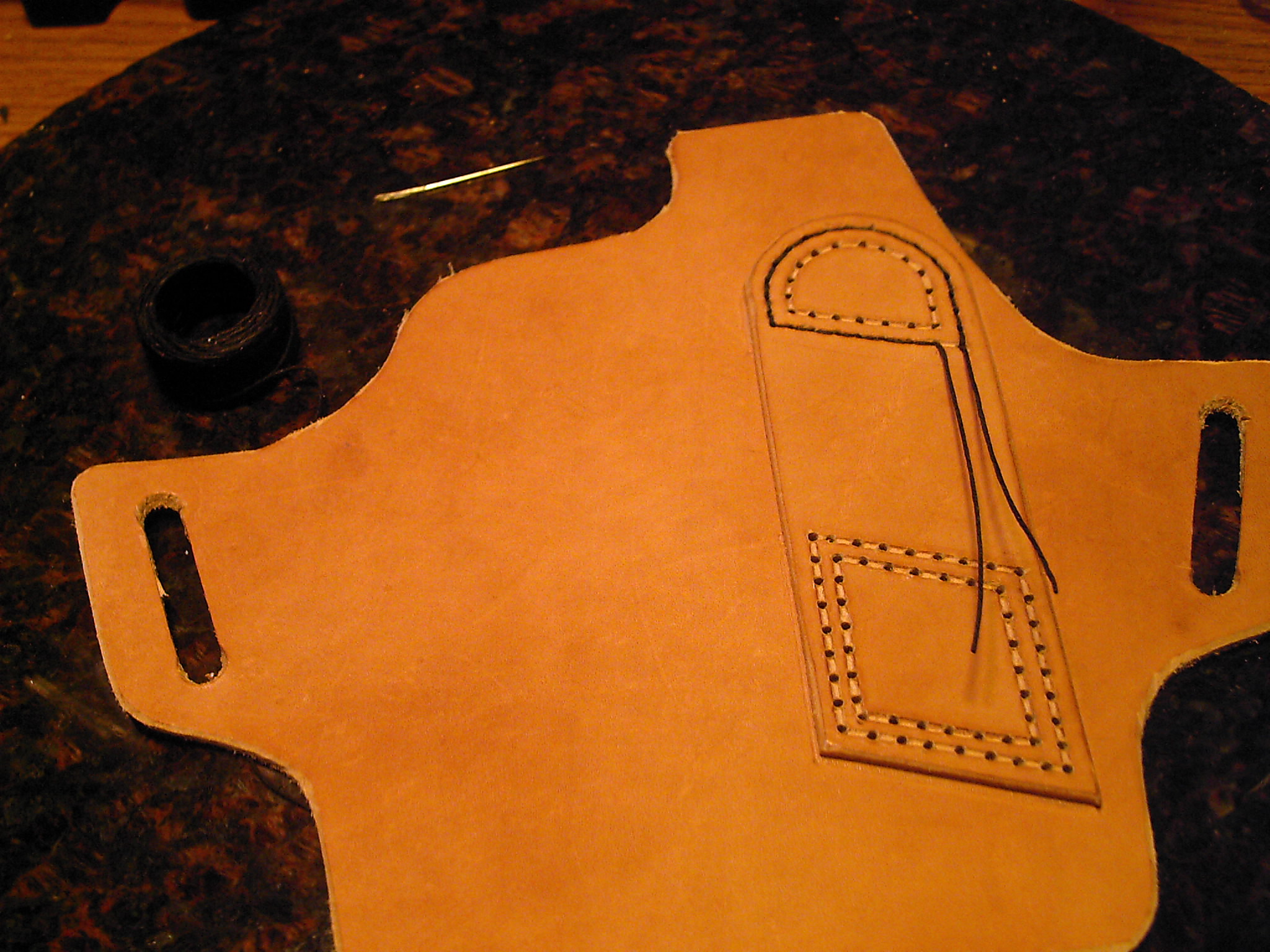

carr52 Posted December 1, 2008 Report Posted December 1, 2008 How can I make a decent looking end to this. All my knots look like, knots. Just want my peice to look better on the inside and out. Thanks, Tom Quote
Contributing Member Jordan Posted December 1, 2008 Contributing Member Report Posted December 1, 2008 One way would be to bring the ends out between the two layers tie the knot snip the ends tuck it in with a modeling spoon and tamp the slight bulge with your mallet Quote
Hilly Posted December 1, 2008 Report Posted December 1, 2008 (edited) How can I make a decent looking end to this. All my knots look like, knots. Just want my peice to look better on the inside and out.Thanks, Tom Hi Tom! If you're saddle stitching, no need to tie knots. Always end with a couple back stitches, and simply snip the thread off close. Looks very neat and won't come loose. The book "The Art of Hand Sewing Leather" by Al Stohlman will have you stitching like a pro in no time! Hilly Edited December 1, 2008 by Hilly Quote
Ambassador pete Posted December 1, 2008 Ambassador Report Posted December 1, 2008 How can I make a decent looking end to this. All my knots look like, knots. Just want my peice to look better on the inside and out.Thanks, Tom take each end and continue in the same direction(s) 1-2 holes and cut off flush. Basically like backstitching but in opposite directions. no need for a knot pete Quote

carr52 Posted December 1, 2008 Author Report Posted December 1, 2008 Well here's how it turned out. I think I need a little more practice on this but it looks a whole lot better than what I was doing. Thanks for the help. Tom Quote
Members celticleather Posted December 1, 2008 Members Report Posted December 1, 2008 When you've cut off the ends of the thread, if you still have an annoying little 'tail' showing, gently poke it back into the hole using the eye end of the needle. A little tap with a flat (cobbler's) hammer (with a good flat surface beneath) will even out the stitches. Quote When everyone is somebody, then no one's anybody
Hilly Posted December 1, 2008 Report Posted December 1, 2008 I usually use an overstitch wheel in the stitching groove to mark where the stitches will go. After I finish stitching, I take my mallet and gently tap the stitches down into that groove, and then follow up with the overstitch wheel on top of the stitches. Makes your stitches look nice and uniform, and lay flat in the groove. Quote
