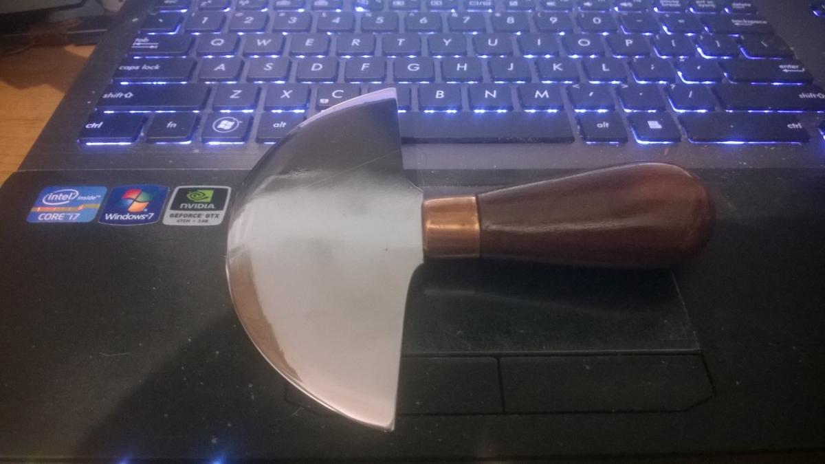

Hello All,
Please help save my Round knife. On the advice a neighbour I sent my Round Knife to have the brass ferule fixed. Please view the image of the result - they have ruined the knife. It is my favourite tool and have been using it for the last 20 years. Is it worth saving or repairing and if so how and where? Ideally UK based but willing to send further afield if needed.
I believe that the newer versions of the same knife are not so good in quality (Osborne Round knife). Any advise welcome. #heartbroken!
Kindest regards
JCUK

It does not look fixed at all... Where did you send it to be fixed, the local grade school shop?
Edited by Bonecross
I could be wrong due to the picture but the handle looks a little rotten. Anyhow the handle can simply be replaced. Push out the brass pin and pull off the handle. Now either you make a new one yourself or try to get a replacement handle from Osborne or just replace the brass ferule.
The least you'll need is a new brass ferule and new brass pin.
The CSO knives of the '80s and '90s are every bit as good as the older ones.
I don't see any repair.
I have a CSO in that very condition, it happens to them all the time. If I have a split ferrule on a tool, it always seems to be a CSO, must just be a thing with their ferrule design.
Fix it yourself. Call CSO and ask for a ferrule for your knife. Put it on and wait till it splits again.
Fix it yourself, make your own ferrule. Drive the pin out and take the blade out of the handle. Get a piece of the right size (take the handle to the hardware store) copper tubing (look in the scrap bin, don't buy a 10 foot section) and a cap that fits (maybe you should buy two to be sure), put the cap on the tubing (solder or attach somehow) and cut to the length you need. Sometimes, just the cap will be enough for the ferrule; most of the time that is the case. The ferrule is just there to keep the handle from splitting, so it can be shorter than the factory ferrule. Now squash the completed project in your vise till you get the size you need to fit the handle. Take your Dremel (or whatever) and cut the correct size slot in the top of the cap. Do a little "fitting up" as you go. Fill in the handle (or do like I do and use JB weld to do the fill-in when you put the ferrule on for the LAST time, if you use JB Weld, it WILL be the last time). Put the blade back in and the pin and you are finished (after an hour of so, you can polish the copper). I might open the pin hole up a little and put a special pin in to let everyone know I've been there.

Thank you all for your replies.
Bonecross it does look like it was repaired by a kid and i have since been told the place i took it too, jobs like these they give to the apprentices. So i am not happy to find this out afterwards.
Thor good idea i will try to contact Osborne direct, we have a UK supplier of Osborn tools over here not sure if they will bother to help me but will see. If not, i will contact the Osborne USA direct. By the way the handle is not rotten, it's actually burnt! Where they tried to weld the brass ferrule.
Art, if I can't get any joy from Osborne over here or the USA i will endeavour to try and make a handle myself I have already sourced some brass ferrules on eBay. Thanks for the correct spelling of ferrules! LOL.
TinkerTailor, thanks for your reply but wonder if your suggestion is beyond my capabilities of working with metal working tools and wood working tools.

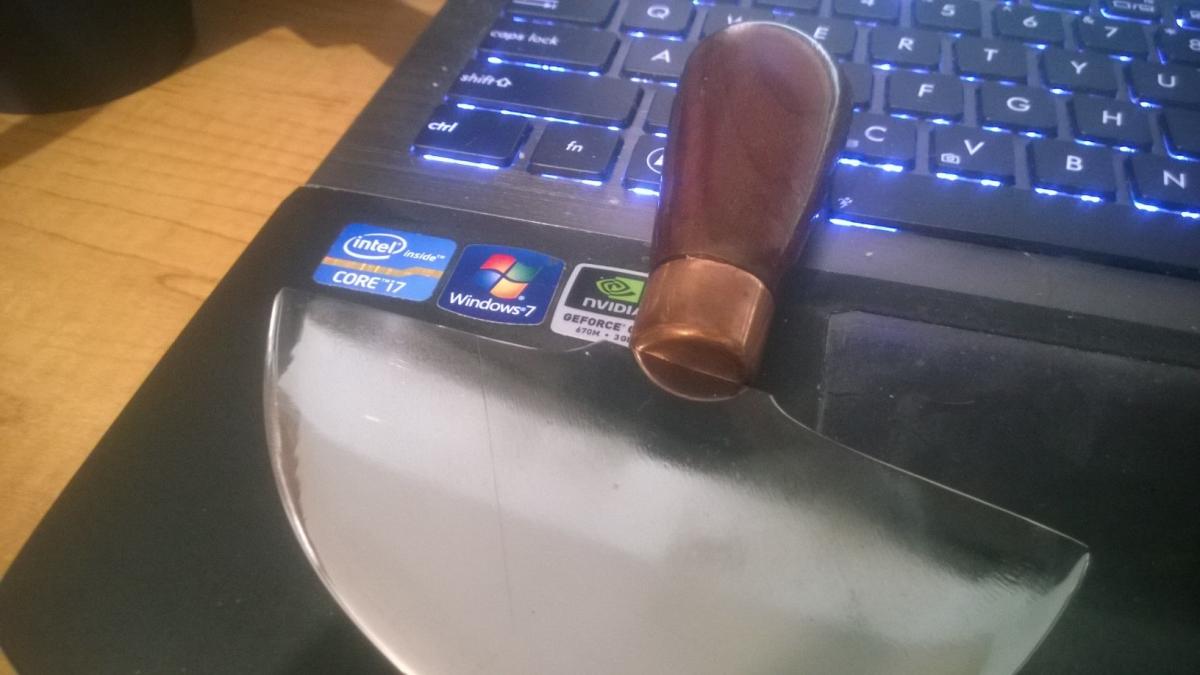

I have contacted a company here in the UK, that make knives and i have asked if they can make a replica or something similar out Damascus steel. As a little treat to myself and the pic attached is their work. This knife is 6 inches point to point and is too big for me.
Kindest regards and thanks again
JCUK
post-29820-0-83575600-1447016651_thumb.j
