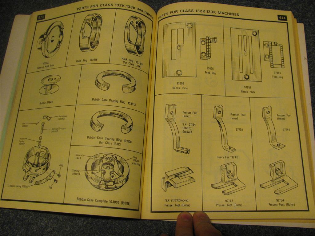

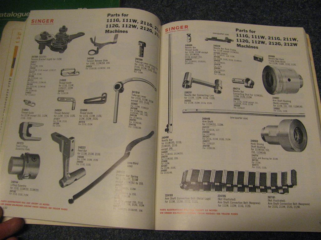

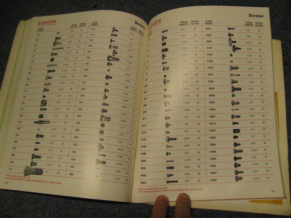

Got a nice lot of original Singer paper work from a saddlery in GB. ;)
Original Singer Parts catalog from 1973/74, parts catalog from Bogod Co (not only Singer parts) and a bunch of original Singer technical bulletins. Great information on parts, needles, screws, subclasses and so forth. Nice information on some 45K and 111w machines. Too many page to scan and post here but I think I will put some of the bulletin's into a PDF and post them.
