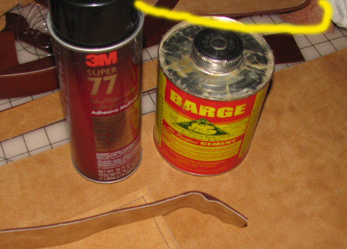

3m 77 = epic fail. It stuck great at first, now a few days later if you bend the leather just a little it comes apart.
post-43570-0-26889800-1457582061_thumb.j
The piece outlined in yellow was done with Barge at the same bench with the freshly glued straps and bag panel. Vapor did it in?!! The piece the cans are sitting on is almost a 3rd of a side and it is doing the same thing :bawling: :bawling: :bawling::censored2::ranting2::censored2::ranting2:
