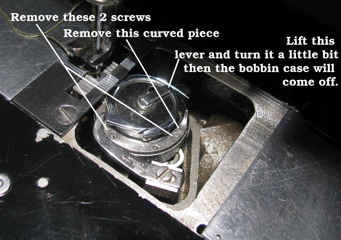

Members LoveToLearn Posted February 18, 2016 Members Report Posted February 18, 2016 I have adjusted the screw but even at maximum tightness there is ZERO bobin tension. Is it possible that little spring got stretched when I had a tangle and was trying to pull it free? I have taken the sliding plates off and the feed dog cover and looked in there at the little spring. How can I take the bobbin case out so I can examine the status of that spring and bend it back into shape? thanks LoveToLearn Quote

Members Constabulary Posted February 18, 2016 Members Report Posted February 18, 2016 Have you turned the right screw? There are 2 on the spring one for holding it (the right one) one for the tension (the left one). The 111 are old machines and the spring is a wear part like the entire hook an many other parts. Sooner or later you simply have to replace it. When you are buying a new spring I´d buy new screws too. They are tiny and when you loose em you are screwed. See attached picture Do you have a parts list and manual for your machine? If not download them. Quote

Members LoveToLearn Posted February 18, 2016 Author Members Report Posted February 18, 2016 Have you turned the right screw? There are 2 on the spring one for holding it (the right one) one for the tension (the left one). The 111 are old machines and the spring is a wear part like the entire hook an many other parts. Sooner or later you simply have to replace it. When you are buying a new spring I´d buy new screws too. They are tiny and when you loose em you are screwed. See attached picture IMG_4233.JPG Do you have a parts list and manual for your machine? If not download them. Nice diagram. Thanks.. Do you know where the cheapest place is to get this part number? I have a parts manual. Im assuming the number is in there but where is the best/cheapest place to get a genuine singer part? Also I was wondering, is it normal for the bobin case to oscilate slightly? Thanks fellas. LoveToLearn Quote
