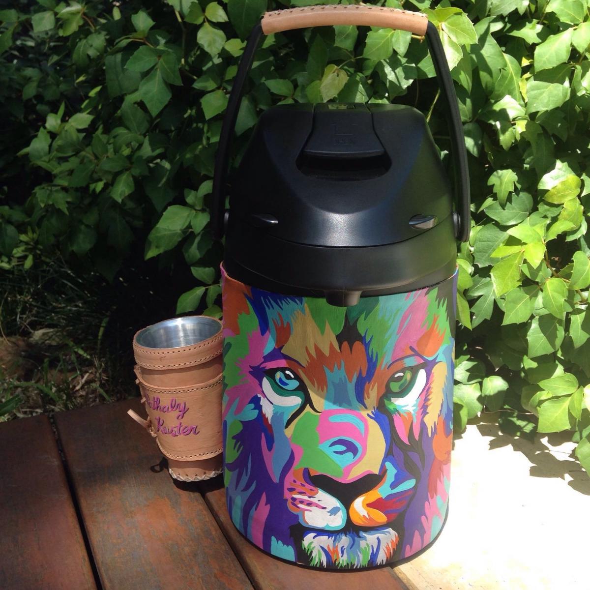

Members Leonguaranipy Posted February 20, 2016 Author Members Report Posted February 20, 2016 Here's an example of our work Quote

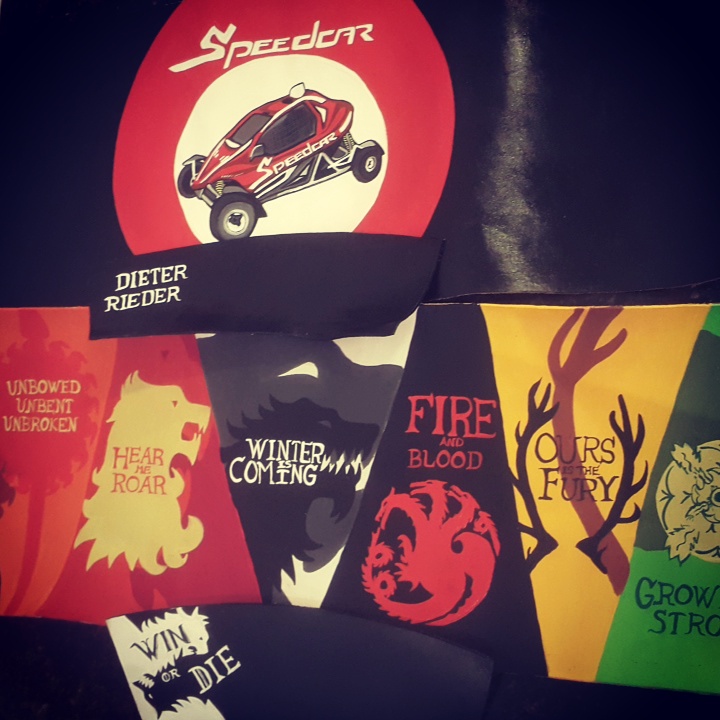

RockyAussie Posted October 11, 2018 Report Posted October 11, 2018 I cant say anything about fiebings acrylic paint as I haven't used it myself. I have used a lot of others in the past and can only advise my thoughts from that. Being a dog collar I would been tempted to use a spirit dye first as the paint generally break down in time with this sort of use. I notice that the edges are fairly square except around the buckle area and I think the metal keeper has a sharp edge on the inside of it that is scraping the paint off each time it is done up perhaps. Whenever I do coloured edges I start by rounding of of the edges by sanding and not making it too smooth as some others seem to do. The reason is that you want the paint to get down in the fibres and really hang on. This is normally followed by a couple of coats of paint until it is not looking too rough any more. I then iron this in with a temperature controlled soldering iron but it can be sanded back to smooth if that is easier for you. I prefer the iron in method on most paints as it tends to have a more durable finish in the longer term. After that I normally apply a couple of more coats to really make it look good but probably not needed on a dog collar really. I normally do this for crocodile products as in picture below.To finish I just polish with a clear wax. Quote
Members Zuzana Posted October 12, 2018 Members Report Posted October 12, 2018 (edited) Waaaaaw the colours on the first picture are really beautiful.How do you get such a beautiful result? what kind of deys you are using? Do you think Angelus dyes would be better as I was thinking to try it on . So I dont have to put anything on the leather before I start dying or painting the leather?Shall I do the edges first before I paint or dye it the way that is round from both sides? also when I look at the collar the leather seems to be very dry so the colour comes off quicker that´s what I think I would like to have the leather real nice.what kind of iron you are using as I have no idea what you are tallking about /never heard of it yet / Pleeeease help me Edited October 12, 2018 by Zuzana Quote
