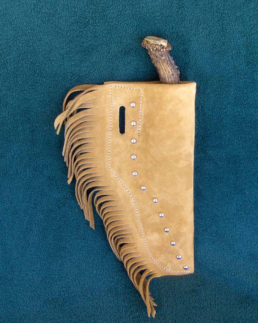

Members Dwight Posted March 17, 2016 Members Report Posted March 17, 2016 I did a special knife sheath some years ago, . . . IIRC, . . . I wet then molded the rawhide to the shape I wanted. I then let it dry, . . . contact cemented the thing where I wanted it, . . . broke out my trusty Tippmann Boss, . . . and stitched it all together. I liked it, . . . he liked it, . . . May God bless, Dwight Quote If you can breathe, . . . thank God. If you can read, . . . thank a teacher. If you are reading this in English, . . . thank a veteran. www.dwightsgunleather.com
