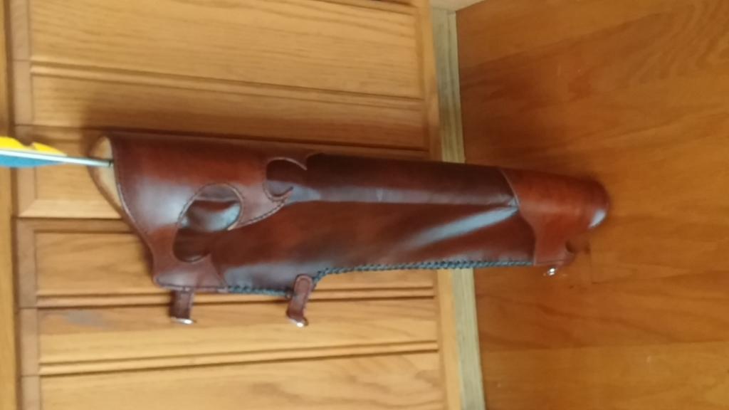

post-52648-0-48567700-1458049944_thumb.j
A quick and dirty convertible back/waist quiver I made for a tutorial. 25" high x 12" circumference (arrow holding capacity not actual width) made for a 28-29" arrow. There is a 1" foam block in the bottom to bumper arrow tips.
