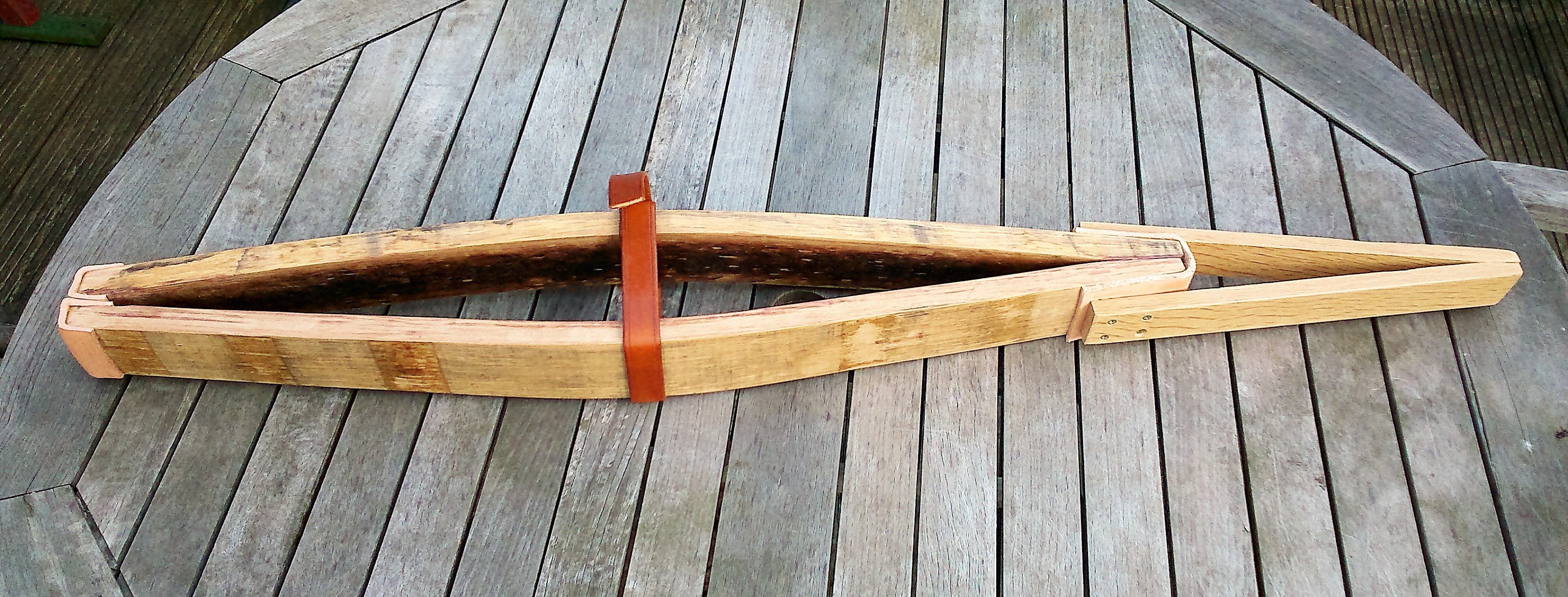

Members MY63 Posted April 29, 2016 Members Report Posted April 29, 2016 Here is my home made effort I started off with two barrel staves from a cooper, The spring is sullied by the two strips of oak screwed to the bottom. I added the strap to secure smaller projects. If I were to make another I would angle the top to thin it down to make it easier to sew small items. I have pictures and a how to on my blog if anyone would like to see more pictures Quote
