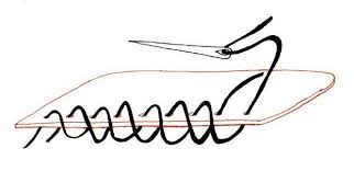

That is done by hand by whip stitching all the way to the end and back again through the same holes. It can be done double needle as well. It is faster and easier to do than saddle stitch but is not even close to the durability. The stitching is exposed on the highest wear area of the item and if one stitch breaks, it will unravel for sure. It also uses way more thread than saddle, which can be a pain in long runs.
Image result for whip stitch
