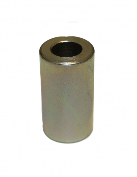

Uwe Posted February 24, 2017 Report Posted February 24, 2017 (edited) I tried out a concept I had in mind to extend the manual foot lift lever on 441 class machines. The topic had come up with folks installing a swing-down edge guide on their Cobra Class 4 machines. The offset of the hand lever to the right avoids interference with the edge guide and you can use both at the same time. My experiment is more of a proof of concept and looks a bit crude, but it works quite well and feels very solid. The gravity based automatic release when you press the foot pedal works too, which is important I think. My threads are 1/4"-20 which is a bit coarse for this application and wants to work itself loose over time as you operate the lever. A drop of Lock-Tite on the threads might help with that. Here's the original hand lever on my Cowboy 4500: Here's the extended version I made. I used a 3/8" connecting rod nut, drilled out one end with 10mm bit to fit the protruding shaft stub and then drilled and tapped holes for the set screw and the ball lever. The extension could be executed in a more elegant and polished fashion, but I was on a mission to just try and see if it works at all. A "proper" version could be made from a 10mm bushing sleeve like this one sold by KarTek for $4.99: or a 10mm sway bar bushing like this sold by IRO for $1.99 Of course if you have a lathe in your garage, you can just make one from scratch. Edited February 24, 2017 by Uwe Quote Uwe (pronounced "OOH-vuh" ) Links: Videos

Uwe Posted February 28, 2017 Author Report Posted February 28, 2017 I made a second prototype of the hand lever extension. This one looks a bit more polished, has improved ergonomics and a pretty red dot to aim your thumb at! I'll probably make a handful of them later in March and see if somebody will buy one. Quote Uwe (pronounced "OOH-vuh" ) Links: Videos
