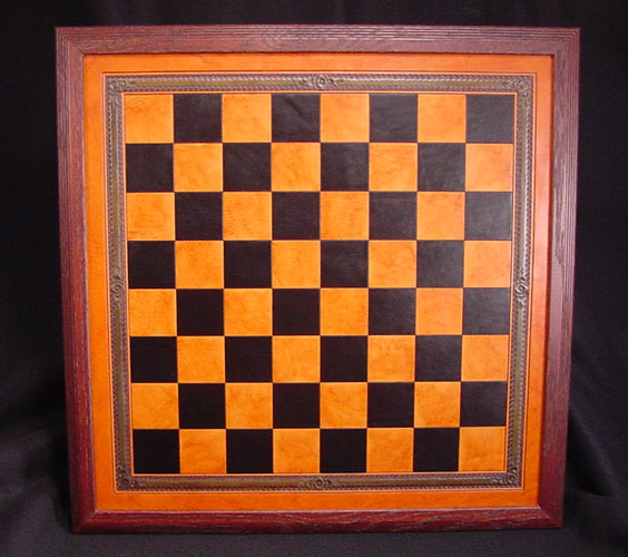

Members CitizenKate Posted June 7, 2007 Members Report Posted June 7, 2007 (edited) I use it to make leather game boards. The leather is mounted permantently on a piece of MDF, and the tooling is done on it after it is mounted. I used to use plywood, but the MDF works much better because of its smoothness and rigidness. Kate Edited June 7, 2007 by CitizenKate Quote

Members CitizenKate Posted June 7, 2007 Members Report Posted June 7, 2007 I use a latex-based contact cement which coats the surface pretty thoroughly, so the part that the leather touches is sealed quite well. MDF resists moisture MUCH better than particle board, but if you soak it long enough, it will begin to swell. Kate Do you seal the MDF before mounting the leather? Or, do you depend on the glue to keep moisture away from the MDF? Does MDF swell from moisture like its predecesor (particle board)? Quote
