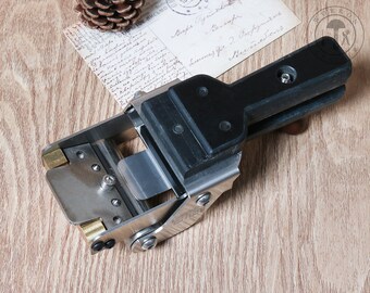

Members billybopp Posted September 23, 2020 Members Report Posted September 23, 2020 Powered skivers are fairly pricey, but pull skivers are more affordable, but limited to 3-4" width. That should be plenty for all but the biggest sheaths. We're still talking about a couple hundred $, but far less than the thousand $ for a power skiver. You can also skive by hand using a safety skiver, but that takes a lot of skill and practice. - Bill Quote

Contributing Member fredk Posted September 23, 2020 Contributing Member Report Posted September 23, 2020 I use this for skiving the ends of belt straps. It will cope with up to about 60mm wide This might do strips wide enough for sheaths. You can buy it from about £25 to £95 depending on the seller. Mine cost me £28 Quote Al speling misteaks aer all mi own werk..

Members Chris623 Posted September 23, 2020 Author Members Report Posted September 23, 2020 On 9/23/2020 at 3:01 PM, fredk said: I use this for skiving the ends of belt straps. It will cope with up to about 60mm wide This might do strips wide enough for sheaths. You can buy it from about £25 to £95 depending on the seller. Mine cost me £28 Expand Thanks for that. Never have seen a tool like that one! On 9/23/2020 at 3:05 PM, zuludog said: The decorative/exotic inlay piece is placed under the front part but doesn't reach as far as the edge; it is sewn just around the border of the hole Skive the edge of the inlay and under the perimeter of the hole so that it isn't too thick, and doesn't have a step on the front piece Alternatively use an inlay that reaches to the edge of the sheath, and skive both the inlay and the front piece so that the edge of the sheath isn't too thick . Skive and sew down around the edge of the hole Expand Appreciate that. I was under the impression the exotic went all the way to the edge of the sheath and was stitched in with the rest of the layers. Quote Chris "All things are difficult before they are easy." (Fortune Cookie Proverb)
