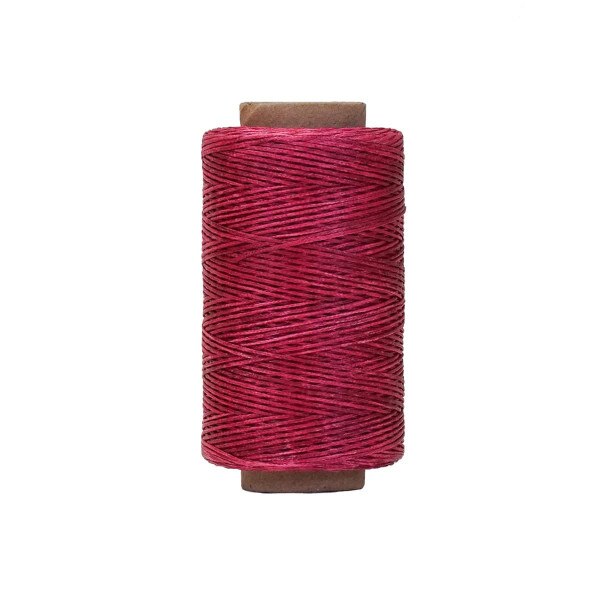

RHST.Magenta.01.jpg?resizeid=19&resizeh=
Retail: $4.99
Order Summary
$4.99 Subtotal 1 item
Ship to: my zip
$7.96 Shipping
$12.95 Estimated Total
Here is the problem a $4.99 item and the shipping is $7.96
VS
Amazon    $8.99 and free shipping
Difference of 4 bucks per roll,
FREE Shipping
Edited by Frodo

Yes I will go in and see if we can get something figured out. And give those working on the new shipping quote system a push.
So I did a quick check on this and it has to do with the sizes or certain items and customers were just choosing First Class shipping for everything, but not all items by weight can actually fit in the box size for First Class.
However if you call in then we can do First Class over the phone. Amazon is cheaper if you only buy one spool of Rhino, but you should be able to ship 3 spools for the same price as the you could 1 on the website.
Like I said though...this is something we are working to get resolved, but fixing 10,000+ items is daunting at the moment.
