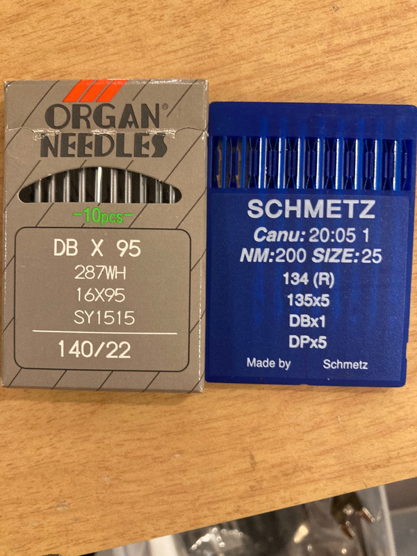

A- The needle that was in the machine (the one that I broke), had a flat side to the part that mounts in the needle holder, but these spare needles that were in the drawer are all round, with no flat side. Guessing that might have something to do with why they didn't work? I had no idea the world of needles was so complicated…. Found in the paperwork that they gave me with the machine that I’m supposed to use “16x87” needles, but those seem pretty rare, are there any more commonly available needle systems that would fit/work?

Needles: The needle that you broke sounds like it was a domestic sewing machine needle. Industrial sewing machine needles do not have flats on the shank. The best idea it to use a slightly different needle system from the one that machine was originally set up with. Understand that there are needle systems and within that system there are different needle sizes to choose based of the thread you are using and the material you are sewing. I would adjust the needle bar to use system 135x17 for fabric and 135x16 for leather. If using #69 bonded nylon thread, I would use a size #18 needle.
These needles have a long groove down one side and a scarf, or cutout above the eyelet on the other. The scarf side needs to face bobbin or hook side. If the needle is turned the wrong way, it won't form the loop correctly and the hook will not catch it. It won't stitch.

Oh yeah, and regarding the needle thing, are domestic needles shorter than industrial? I found the tip that broke off, and when I put it together to compare, it looked like it was a shorter overall needle than the spares that were in the drawer, which, I would assume would explain things not lining up and catching if the shorter one were what it was adjusted for.... But then again, there may be another fragment of it somewhere that I didn't see.  In case it helps, here's a photo of the two packs of spare needles that were in the table drawer, and the needle that broke.... Let me know if you think I should be able to get either of these spare models working... Thanks again!

If it works with a domestic needle then it's likely that the needle bar has been re-adjusted and will need to be reset.  You need to check the adjustments and timing of the needle and hook. As JJN said if you can set it to work with 135 needles then it will make life easier as they are a very common type. And in my opinion get rid of the old motor, it belongs in a museum as given its age the wiring insulation is likely to be brittle and cracking so potentially dangerous. A servo motor will make sewing much easier.
