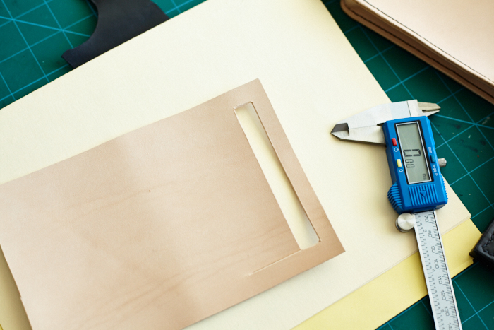

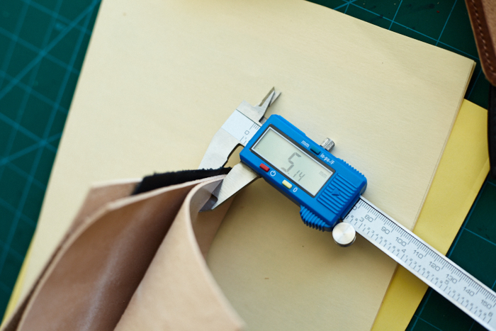

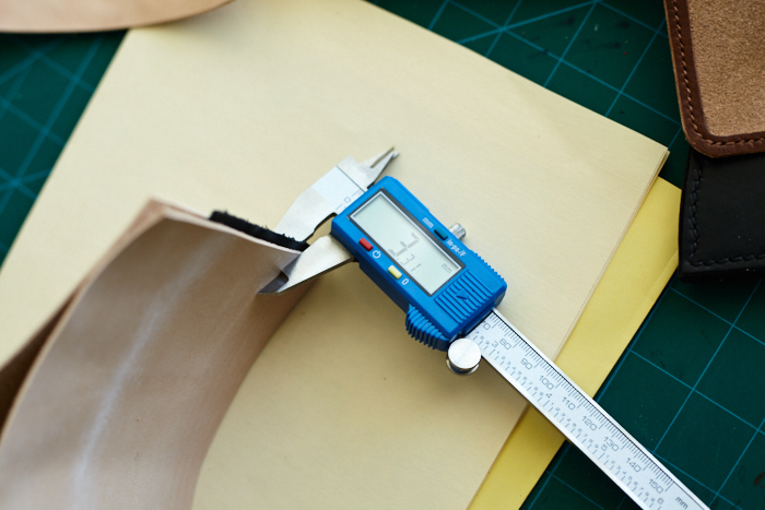

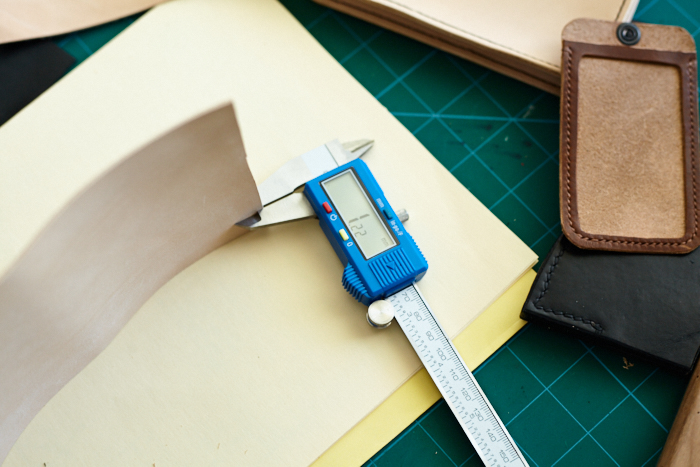

Members PhilDimashq Posted November 25, 2020 Members Report Posted November 25, 2020 (edited) Hi folks, Phil from Ireland here. I'm still very new to leather work and I put up my first post yesterday to show what I've been up to so far. Spent a lot of time analyzing my results, looking at what didn't work, checking the forum for answers and following the likes of Nigel Armitage, Ian Atkinson, Terrick from Chartermade and so on. There's been some wrong turns, but generally each new item sees some improvement on the previous (even if it's only a tiny improvement) This post is about my most recent project : my first billfold, pictured below. It's made from 3 oz (1.2mm) veg tan, dyed with Fieblings pro dye, and stitched using a set of cheap 3.38mm pricking irons, an absolutely amazing awl from Kevin Lee, and 0.6mm tiger thread. For me it's my best result so far but of course there's still plenty of room for improvement. I'm planning on making another for my brother for Christmas and I've some queries that I'm hoping the good folks here on the forum might be able to help me with. I have searched for the answers to these questions without success, so if they've been asked and answered before, my apologies in advance. Lining the wallet I'd like to line the bill section on my next version and am unsure of how to do so. I've some nice thin pigskin that I think would be lovely. Here's my questions - When you line a billfold do you line both sides of the bill pocket? - How do you deal with edges ? I have seen people roll the edges all the way round but that's beyond my skill level at the moment. I'm guessing the lining is glued and cut up to the stitching line, so it's caught by the stitches but doesn't go right to the edge. However, I'm unsure what to do at the bottom of the bill pocket. This would be visible when the wallet is open (under the curved bit in the middle). T Pockets I need to check my dimensions of the t part of the t pockets so the stitches all line up and are the same size as this didn't work great in my first attempt. I've seen some projects where the stitch straddles the joint and others where the stitch falls in the gap. To my untrained mind, I think it should straddle the joint i.e. a stitch hole on either side with the thread going over the join. - Is this correct? Also, is there any difference or reason for cutting the "inner" or hidden part of the t pocket as a square shape or an angled shape? I see folks doing both and am unsure if there's a reason or it it's just down to personal preference ID Pocket I'd like to add an ID pocket for a drivers license. However, I'm unsure if the assembled pocket should be two or three layers. One option is the acetate wedged between two pieces with cut outs and then this sewn to a backing piece. The other option is the acetate just covered with a single piece with a cut out and then this sewn to a backing piece. I'm leaning toward the second simply to keep the thickness down but I'm unsure if this is a good way to do it. So if anyone has done this and can share some tips I would greatly appreciate it. Stitching I've been working on this for a while, and the new awl certainly upped my game a bit but took some getting used to. Kind of figured it out towards the end of the last project when sewing along the top and was quite happy with result on both sides. There's one sort of issue that I'd like to check. Not sure if this is a problem or not. The awl is extremely fine (1.9 mm). I sew from the right so my process normally is : awl from right, left needle through, then right needle through over thread from the left needle, cast stitch at the back (on the left) and tension However, I'm having difficulty finding the awl hole when coming with the first stitch i.e. from the left with my needle (my "blind" side). So now I'm putting the awl in from the right, then using the needle on the right to open the hole a bit before going first stitch with left needle in, then right needle etc I'm just a bit worried that doing it this way might mess up the hole on the left hand side (the "wrong" or back side) Not experienced enough to see the difference if indeed there is one, so just wanted to ask does anyone see this as a problem and if yes, what can I do about it. Sorry if this is a lot of questions but I haven't been able to find answers for these anywhere. A big thanks in advance, All the best, Phil Edited November 25, 2020 by PhilDimashq Quote
