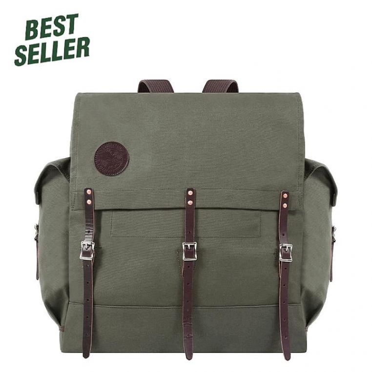

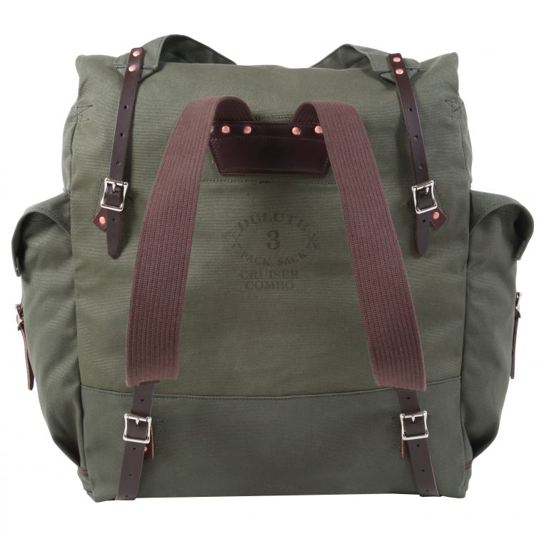

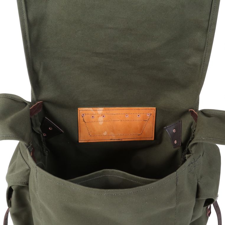

Members LanceR Posted June 6, 2021 Members Report Posted June 6, 2021 Hello All I have a Consew 226R-2 and need advice on starting points for needle/thread choices for sewing Duluth canoe pack style canoe packs in 15-18 ounce canvas and for attaching straps and backing pads to them. I'm looking to use similar construction techniques to the Duluth canoe pack shown here. And using backing pads like these: Any help with recommended thread/needle combinations for the canvas seams and the leather pads would be appreciated. I suspect the leather for the shoulder straps wants to be in the 8-9 oz range but any thoughts on that weight and the weight for the closure straps would also be helpful. Thanks and best regards to all, Lance Quote Current machines: Consew 226R-1, Consew 227, Necchi BU Mira in an industrial table with an antique Atlas clutch setup.
