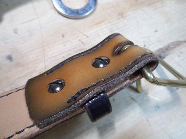

I hand stitch mine. I'm not a fan of staples. I guess you could say mine are "anchored". They are not attached directly to the belt, but are held in place between the two Chicago screws that hold the part that bends around the buckle and back onto the main part of the belt.
post-28681-0-01168900-1357340185_thumb.j
post-28681-0-36733900-1357340193_thumb.j

I hand stitch mine as well. It is a floater, but held pretty tight by the screws at the buckle end.
