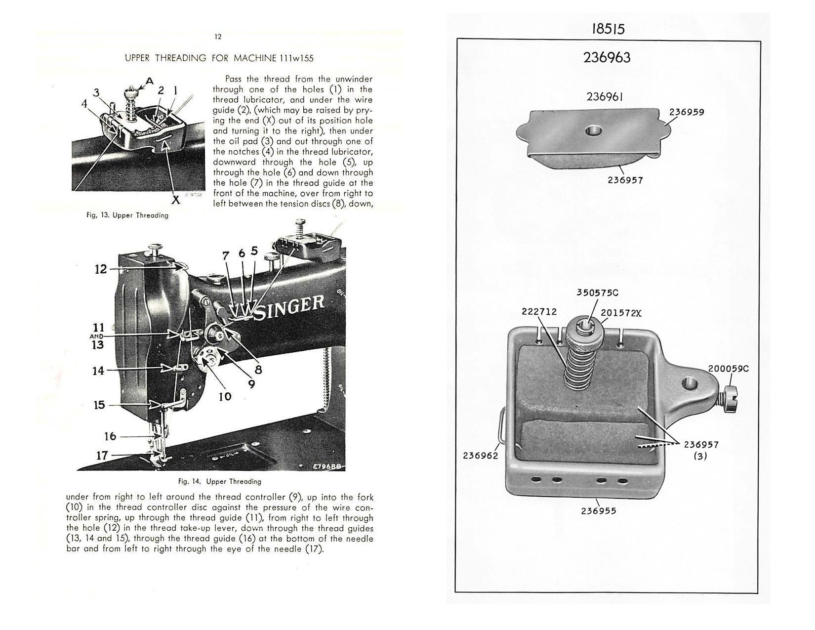

Hi all. I'm new to my Singer 111w155. In reading the manual which is for models 152-155, it describes normal threading for just models 152-154, and then there is a separate page showing the threading for the 155 model, which includes a thread lubricating cup that sits on top of the machine (see attachment). My machine doesn't have it, and from all my searches online, I don't see any other 155s that have it. Just curious, what is it, and does anyone know why the manual describe it as part of the 155 (not optional), yet all the 111w155s I see, don't have it either. Thanks!
Thanks for the info guys. I figured it was just a drip pan to keep the mess contained, that makes sense. As for the missing felt in the oil reservoir, I'm curious I guess. Still trying to figure out those stitch length markings. I can adjust the stitch to the length I want by watching the feed dogs for travel and then with a quick test on scrap piece, mostly just wondering what the numbers mean. @dikman yeah that clutch motor takes off if you're not careful!! It would be fine I was sewing awnings or something with long uninterrupted seams, line it up stand on the gas pedal!! Too hard for beginner to control for smaller stuff like I plan to be doing. And I've been driving cars, heavy trucks, motorcycles, tractors etc with clutches for most of my life.

If the pan you've fitted is working at keeping the oil off you then I wouldn't worry too much about getting the correct one. As for oiling, you don't have to use the wick system, just oil it manually. Basically just give any parts that are rubbing/in contact/sliding etc a drop or two of oil. If you can master that clutch motor then well done but life will be easier if you swap it for a servo.
