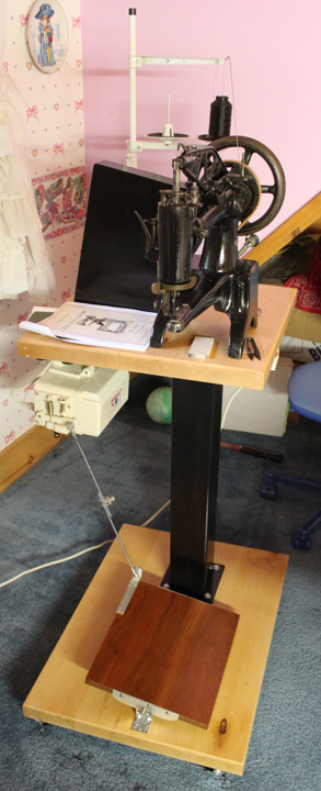

This is a project I have been wishing to do for some time. I believe it came out well, do not believe I would do anything different.

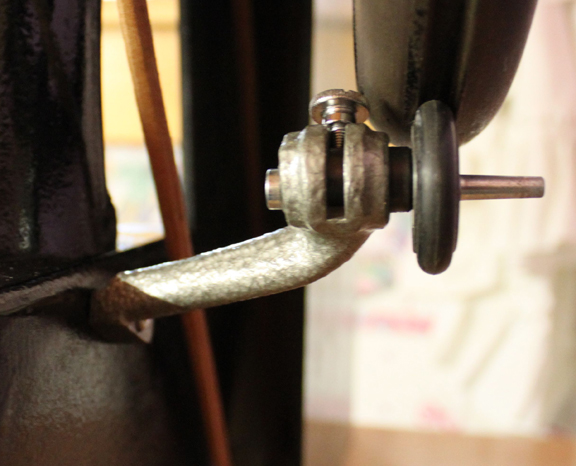

I took some liberties in rebuilding this beautiful old machine. Cleaned and removed all old paint, repainted with gloss black, have not applied the decals at this time.
The bobbin winder is new. I moved it down to the base of the machine from it's original position so the rubber tire would touch the drive wheel groove properly. A few new screws, new belt, needles, and some other items I will show you.

A close-up of the bobbin winder.

The bottom is of 1 3/4" Maple with casters (two of them lock). Foot control is of Cherry, I fabricated the movable parts of the control from aluminum, bronze and steel. Servo is a digital 600 watt from Bob Kovar. I slowed the top speed of the servo to 200 rpm plus attaching the belt to the larger of the two belted pulleys. I can sew i/8" leather, one stitch per at 8 stitches per inch, top speed with this setup is a little faster than I wish to run the machine at this time. Control with the pedal is excellent. I have about 2 1/2" of travel before hitting top speed.
The bolts/machine screws originally used appear to be of 28 tpi, a size of thread count that is pretty much impossible to find locally. Bob has them. Bolts to hold the machine onto the original cast iron table were 3/16" 28's, I drilled them out and replaced with 1/4-20's. I attached the bobbin winder with a 10-24 bolt replacing the 10-28. Odd looking black box to the rear of machine is covering the belt. Pedestal is of 4 x 4 x 1/8" steel with 1/4" steel plates on each end. I will be making a larger than normal drawer to fit under the top table for tools etc.
Thread stand was a must since the machine obviously used small spools of thread on the post. I fabricated a piece of Piano Wire to fit over the original spool post and rise high enough to keep the thread away from moving parts of machine. Top end of wire has an "Eye" for the thread.

post-15740-0-73311300-1370561576_thumb.j

Believe it or not it sews perfectly. The bobbin tension screw was tight, loosened it about an eighth of a turn, relieved the top tension. The directions in that old manual are very clear and easy to understand, I had no trouble with winding or loading the bobbin.
Tor,
No speed reducer. The digital servo is infinite adjustment from 3600 rpm down to 200 rpm plus 2" pulley on motor to the 5 1/2" pulley on machine. I haven't tried anything heavier than 8 oz veg tan, had no problem sewing it. The knots are tight and inside the leather. I have a lot of Chrome tanned, will try it soon. Wiz had suggested coating the serrated foot with "Tool Handle Dip" to get rid of the impression in veg tan. I got some the other day but haven't done that as yet.
