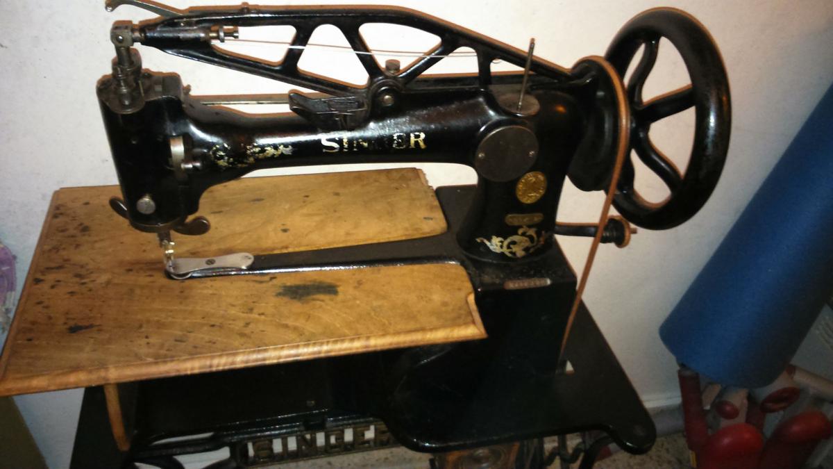

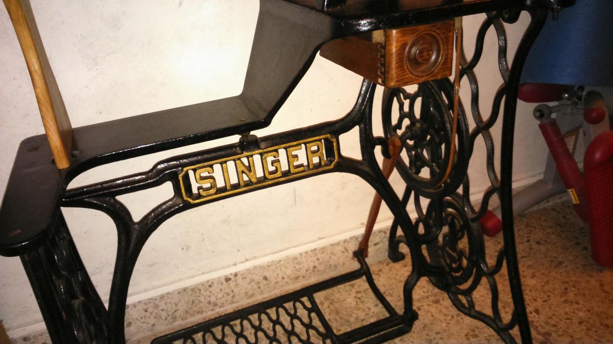

That is one beautiful machine you have, just beautiful. Did you find it with the treadle stand and work plate? Was the machine in that condition?
Are the decals original or replacements? I'm looking for the bobbin winder, wax pot and decals to complete mine. I like it Jimi, really nice. Thanks again.

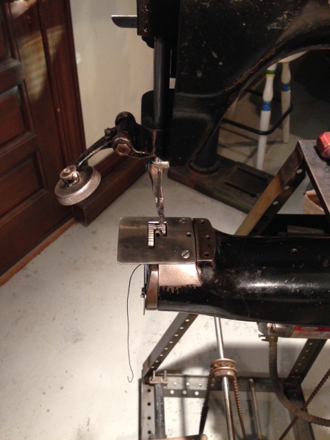

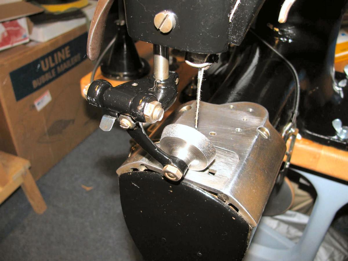

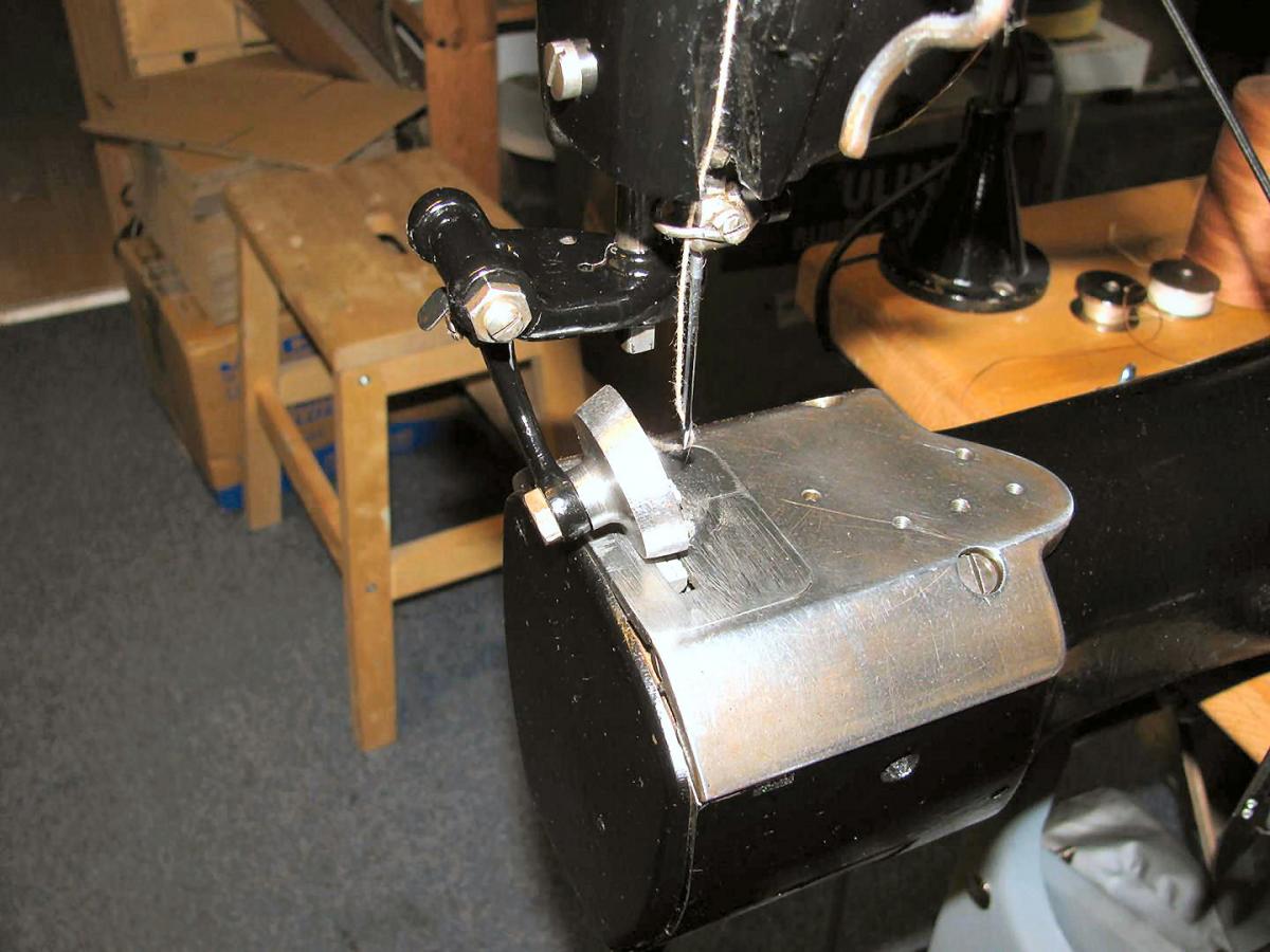

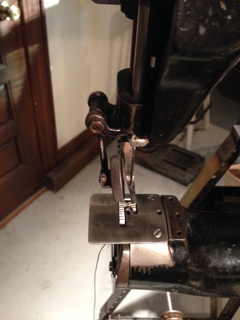

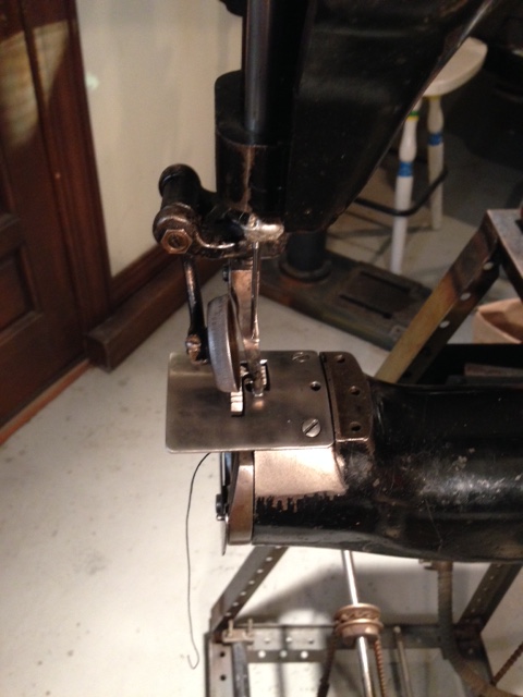

Oh so i bought the work plate from you foker lol! Evo, yes the machine came in this condition and with the treadle included, it only needed to be threaded and oiled. and the decals are original. if you look up the documentery called "the birth of a sewing machine" it is taken in the singer factory in killbowie and at one point you see how they were put on the machines and at another point you see them being made in sheets. that looks like gold leaf they were made of, looks similar to the way you would book bind with gold leaf, stamped/pressed? maybe constabulary can give us a little info on his flaky ones lol? are they made of gold leaf folker?? Good luck with finding the oil box and bobbin winder Evo, remember to get all the screws that go with them if you can. if you are handy with your tools you can make these parts up. i ended up making 5 plates and 3 feed dogs up from some steel plate. for your machine you need to get someone to curve it. i looked for some 6mm steel pipe with the aprox radius then got them to bend the thinner plate over this and made up the plates i needed. first thing is to square up your plate and get your two screw holes in the right place, screw it on and then put in a new needle and mark your needle hole. for your feed dog opening you can either use your old plate or scale up a picture from a parts manual. these were drawn to scale and are good for references (i dont think they are exact). http://dixiesewingmachine.tzo.com/MANUALS/SINGERPARTS2/45K21,%2045K25,%2045K63,%20&%2045K78.pdf.
if your feed dog is original then i would try to file the teeth nearly to a point again, remember you need a good file as they were hardened. the hardest part was the feed dog as this needs to be grinded little by little and the screw hole needs to be milled flat bottom not with a bevel like with a normal drill. i done mine with a small 9mm milling bit in the drill, first with the 9-10mm hss drill then with the milling bit. you can do this in your pillar drill. the two holes on the plate need to be finished the same. otherwise if you find the same thread type on other screws with the bevel head then just change them. Drill out the bulk then fine adjust with a file. here are a coulpe of examles:
Posted (edited)
post-32832-0-20493000-1416667172_thumb.jpost-32832-0-63422900-1416667184_thumb.jpost-32832-0-52231400-1416667213_thumb.jpost-32832-0-51207700-1416667231_thumb.j
the alternative swing fence was made from the measurements of the drawing. the needle plate and feed dog were also made for the right toe foot which came with the machine.

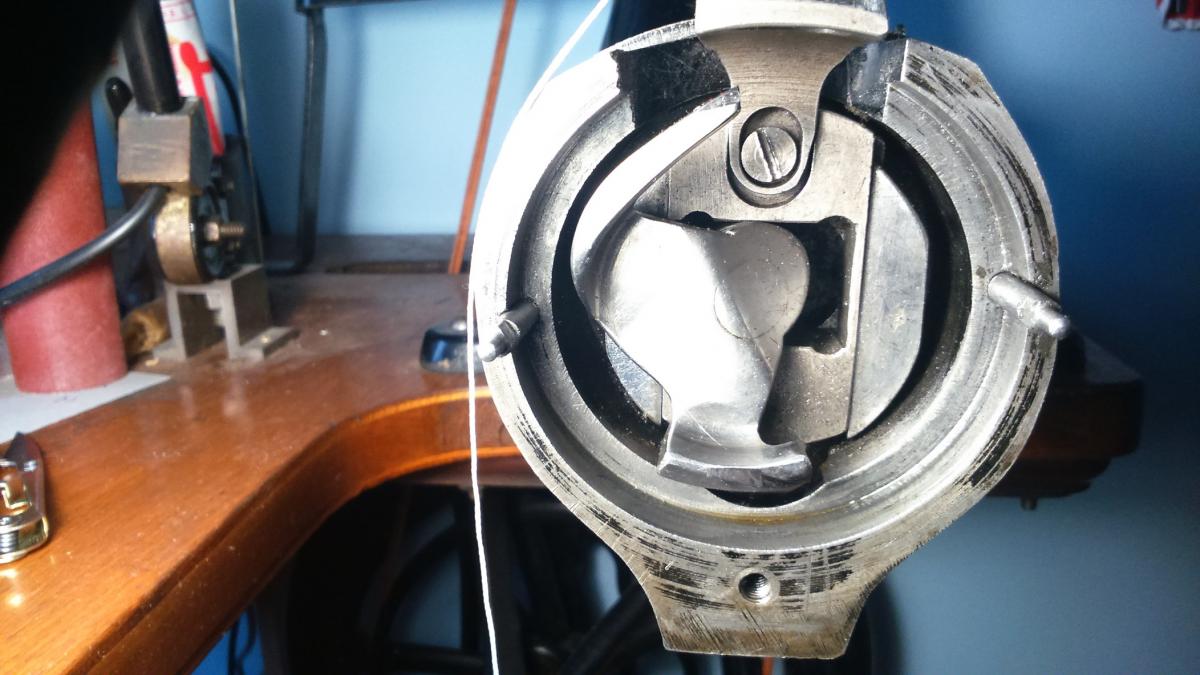

just cleaned and oiled again, and a couple of months latter i was lucky to find a box of needles for this 46k49 fur sewing machine on ebay. they have the long channels on both sides of the needle. nº 215x15 if i remeber. this machine does a chain stitch and is used for joining fur pieces or sewing gloves, Hats and the like i think. the only thing that was wrong with this is was the needle bar was slightly bent so it was straightened and now works again.
