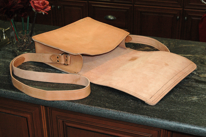

AndyL1 Report post Posted January 14, 2009 (edited) Time to show off what I've been working on. I have a baby coming along in a couple of months and I wanted a little something more manly than your standard diaper bag, so I decided to make a messenger bag. Here is the work in progress. It is all hand-stitched and my fingers are getting very sore from pulling thread! It has an open pocket sewn onto the back. I'm still working on adding the stitch detail in the straps and I have to make the shoulder pad still too. The leather is 5-6 ounce veg-tan calfskin. The strap is 8-9 ounce. The strap is actually two pieces joined by a buckle mid-chest. This way I can adjust the length of the strap if my wife wants to carry it.The rectangular "box" with the snaps on the back is actually a snap-in compartment that fits inside the bag. It snaps in so I can remove it if necessary. It's made to fit a baby bottle. I'm going to make a second one of a different size for my wallet and keys so they don't get lost under diapers and junk. The entire bag will be stained like the small snap-in compartment. I like it to look very weathered and worn out... sort of Indiana Jones style!The celtic knot disc is the first thing I ever tooled like a year ago. I like it alot and to show it off I am going to stitch it to the front flap of the bag. I was going to just tool something right onto the bag flap but I think a sewn on piece kind of adds another nice element to the bag. It is about eight inches in diameter. The whole bag is 15x11x4 inches.Thanks for looking! Any feedback is greatly appreciated.-Andy Edited January 14, 2009 by AndyL1 Quote Share this post Link to post Share on other sites

AndyL1 Report post Posted January 14, 2009 Thanks Alex! Here's another photo of the bag open. -Andy Quote Share this post Link to post Share on other sites
McJeep Report post Posted January 14, 2009 The whole bag is 15x11x4 inches.Thanks for looking! Any feedback is greatly appreciated.-Andy You really ARE new to this baby thing aren't ya? Quadruple those measurements and ya just might have enough room for all the "stuff" you'll be luggin along Looks good guy - and congrats! Rob (btdt too many times ;0) Quote Share this post Link to post Share on other sites
jbird Report post Posted January 14, 2009 Looks fantastic what oz leather did you use. Josh Quote Share this post Link to post Share on other sites

AndyL1 Report post Posted January 14, 2009 Looks fantastic what oz leather did you use. Josh Thanks josh! I used 5-6oz for the bag and like 8-9oz for the strap. And Greybeard, YEP! All hand stitched. The hardest part was doing the corners on the backside. Three layers of heavy leather and making sure the holes lined up right, plus it's got two rows of stitching so I had to do it all twice. I've broken four needles so far. I like doing this stuff for some weird reason though. It's pretty relaxing to me. I am a Graphic Designer by day so anything that gets me to unplug and away from the computer is great. Nice and LOW-TECH! I do use my computer for making patterns and tooling designs though. That makes things way easier. Quote Share this post Link to post Share on other sites
