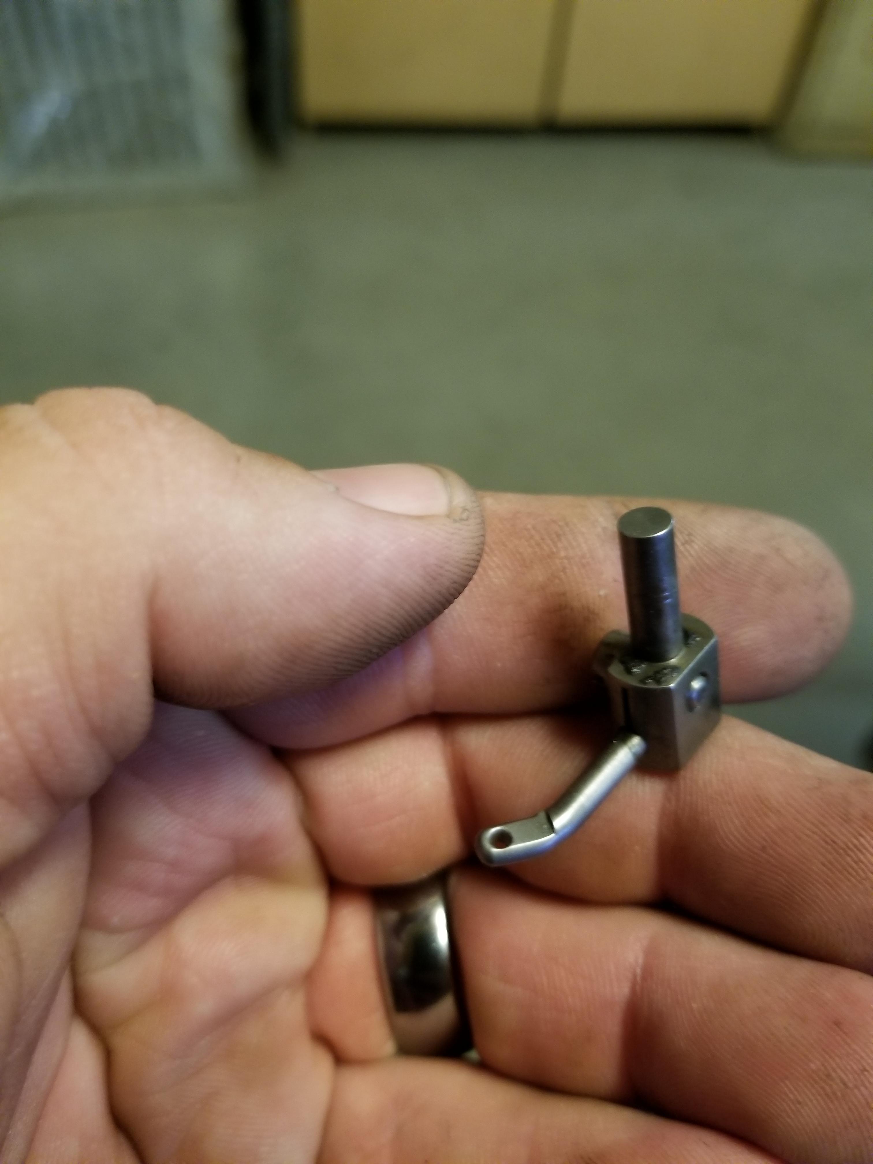

  21. I think the part # for the table plate is 202259, and the hook end on the machine is #210844. Same hinges are used on the 107W zig-zag machines. Googling those numbers pulls up a number of sources, and I think you can still get them from Superior.
  22. They use the Schmetz 331LR needles, which at one point I think were discontinued, but looking online it appears some suppliers show inventory so maybe they started making them again? Landis #1 Needles Parts I highly doubt will be available, other than finding good used parts or making your own. If anyone were to have them, check with Eli Schlabach at Landis Machine Co. in Arthur, IL (217-543-3464). He's mainly in Landis #3 and Landis #16 machines, but he might have something.
