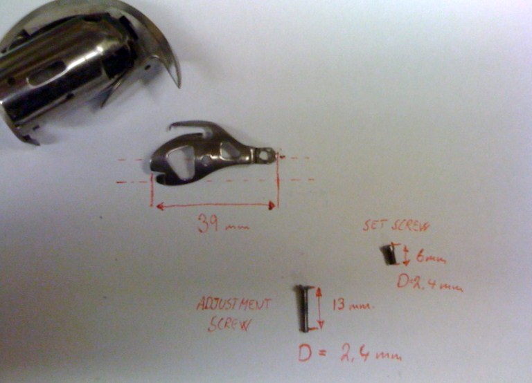

Thanks! But this is an old machine made before the metric standard came. First I thought it was metric treads as well, but metric dont have diameter 2,4 mm. It like this M 2 M2,5 M3 and so on. I got this same topic going in the sewing machine section and I I got some help there to. But Thanks anyway! Trox [, quote name=BIGGUNDOCTOR' timestamp='1286505884' post='169854] Seeing how Adler is a German company I am going to say that it is a metric screw. If you don't know already, a metric screw is sized by the diameter , and pitch (spacing of threads). They differ from inch thread identification in that the pitch is the actual measurement from say one tip to the next one, as opposed to however many threads per inch for an inch thread. Example of Inch threads 1/4"-20. 1/2"-13, etc... Diameter is the first dimension followed by the number of threads in one inch of length. Metric threads 8-1.25MM. 12-1.75 MM Diameter in MM's followed by the spacing of the threads in MM's. Smaller threads will be .5, .7 etc. mm With that being said, do you have a hardware store near you that can get an accurate measurement of the thread s for you? At work I use a micrometer, and a thread pitch gage as some metric sizes are very similar to inch sizes (we have both in use ), and some metric sizes are also close to each other like the 3mm, and 3.5mm screws.and some pitches are also very close between the coarse pitches, and the fine pitches. Other folks who may be able to help would be an auto repair shop, machine shop, or tool supplier. I have an Adler patcher , but I don't know if the screw would be the same. Hope this helped, and good luck.

Hell James! Thanks for all help and thanks for your email to! If you see my answer to Shoepatcher, this are not the correct numbers for my machine! I dont have a part list for it and I cant find it anymore in Durkopp Adler or anywhere else. Weaver leather sayes the have a shuttle who will work, but I can not buy from them with out signing a contract that I should buy for more than 500 USD a year from them. I buy most of my stuff here in Norway and with high import tax and VAT it will be a very expensive shuttle. I better buy a new Sewing machine. But I love my old Adler 5-27, the rest of it is like new. I got all extras that I need, speed reducer and speed adjustable motor. I dont want to retire it as an paper weight. Maybe Shoepatcher can help me. Thanks Trox
Thank You Shoepatcher! For helping me with this! I been looking a whole year for this screw! You are right! The class. 5 is the forerunner to class 105. In the meantime, the standardizations of screw thread happened in Europe and it became a metric system. That was the confusing part for me, that’s why it been taking so long to get the right screw. I was looking for a 2, 4 mm. metric screw that do not exist. The Adler 105 uses metric and the screw part #992 00 560 0 measures 2.8 mm on the threads and 14mm long. The one I need measures 0,096 inches (2, 3 almost 2, 4 mm) It has to be a 3/32 screw. Look at the pic`s attached. How do I find out if its 56 or 64 pitch? Is it the amount of treads on an inch? My screw head is worn out, but I manage to fix the screw down tight so I have the amount of tension I need for thick thread. I also need the tension spring new; I compared mine with a Singer 45 K with an open hook. It looks like it will fit my machine!? Thank again for helping me Shoepatcher!
Help a screw is missing! Somebody knows where to get hold of a machine screw with 3/32 tread? (0.09 inches about 2, 36 millimeter) and ½ Inch long or more (I can cut it) I have been looking all over for a very long time for this screw. It is for my old Adler class 5-27, a bobbin tension screw. (I will buy a complete shuttle if I can find one! But I hope to avoid buying a new machine) In advance Thanks! Trox

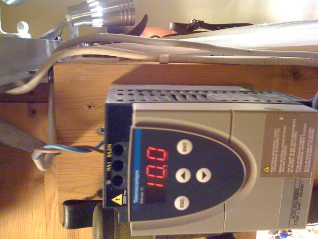

Thanks for the tips! Here is a other solution! An old Adler class 5-27 machine I bought had a 3 phase 3/4 hp clutch motor on it. I living in Norway and I only have single-phase 220v current in my workshop. I had to convert it to single ph or installing three ph current in my workshop. Because of the distance to the fuse box, it would be expensive in cables and no other machine I had needed it. The second problem was the speed, I want it to slow down and be stronger. I called my brother who is an electrical engineers, he gave me a small box called frequency converter it solved both problems. It converts’ the current to single ph and let you adjust the speed. You can even adjust the torque on the motor and read all the data on when it runs. When I want to sew slowly, I set to 10 % of max rpm and 100 % torque and addition you have the clutch control. In addition, I set it up with a regular speed reducer to make the machine even stronger for sewing thick leather, and a potentiometer To adjust the rpm without stopping the machine. I have used this solution for more than tree year, the motor is never warm, and it is very strong. The box I got free but it costs about only a tenth of a servo motor. Trox -

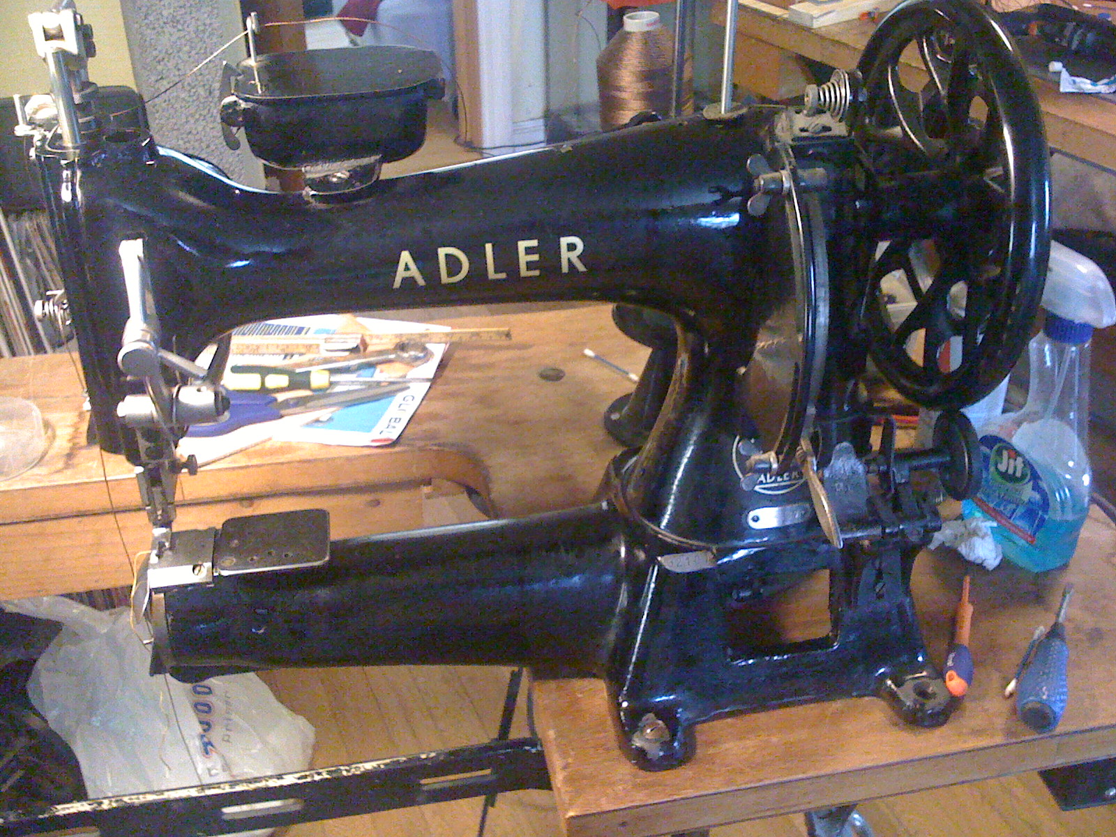

Hi Vaquero1 I have the same machine with cylinder arm class 5-27. Like shopatcher says, the class 4 is the forrunner to the class 104 and class 5 is the forrunner to class 105. Class 4 and 5 is the same machine with a flat bed and cylinder arm. The manual is hard to find! I have tried to find it for some years with no luck. My machine also has a moveable jump foot. I have set it up with a speed Reducer and a speed adjustable clutch motor. In addition, I got many different feet’s, throat plates and Accessories. The machine class is very similar to the Singer class 45k, it so alike that you can use the same manual. http://parts.singerco.com/ in this web site is part lists and manuals. Here are some pictures of the 45K http://www.industrialsewmachine.com/webdoc1/used/used-singers/45k.htm look at the 45K-37 same as yours!? The Artisan 45k manual is also on the Internet to find and use, it is similar but the original is very hard to find. The German company http://www.sieck.de/ has some class 4 and 5 for sale, but no parts and manuals. My machine works fine but I have a problem with the bobbin tension screw (see the pictures) the head is worn out and I cannot find a new one anywhere! If you got a spare, please let me know! The Adler class 4/5 is a very nice machine, but part is hard to find. I got a newer Adler 204-64 who is the successor of the Adler 104 machine, that is a good machine, but the older machine is made of better material and has a and has a much nicer sound, it spins like a cat. The problem is parts of course, if I cannot find parts anymore I have to replace it! There are not so many of these machines in the USA because of the Singer 45k, so you will find it mostly in Germany and Europe. If you know of any bobbin parts for it (Adjustment screw 2,3 mm and 13 mm. long, the screws are in inches because of the age) Please let me know! -

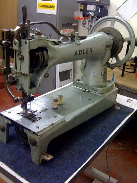

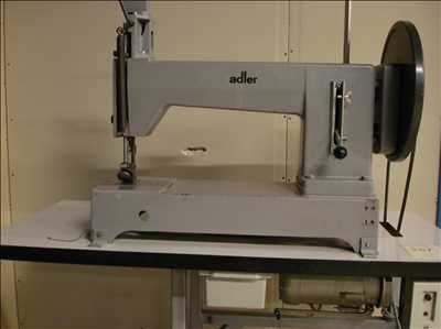

Hello! here is one Adler 120-8 for sale in Norway. And model before that, the Adler 20. These machines are not for sewing thin stuff thats for sure! The machine originates from the Singer class 7, You can se the similarity on the Adler class 20. I want to buy one for heavy harness work, but they costs! Similar model are made today by Consew, Gllobal, cowboy sewing machine and more. But you maybe know this from before! But here is some pics. Trox

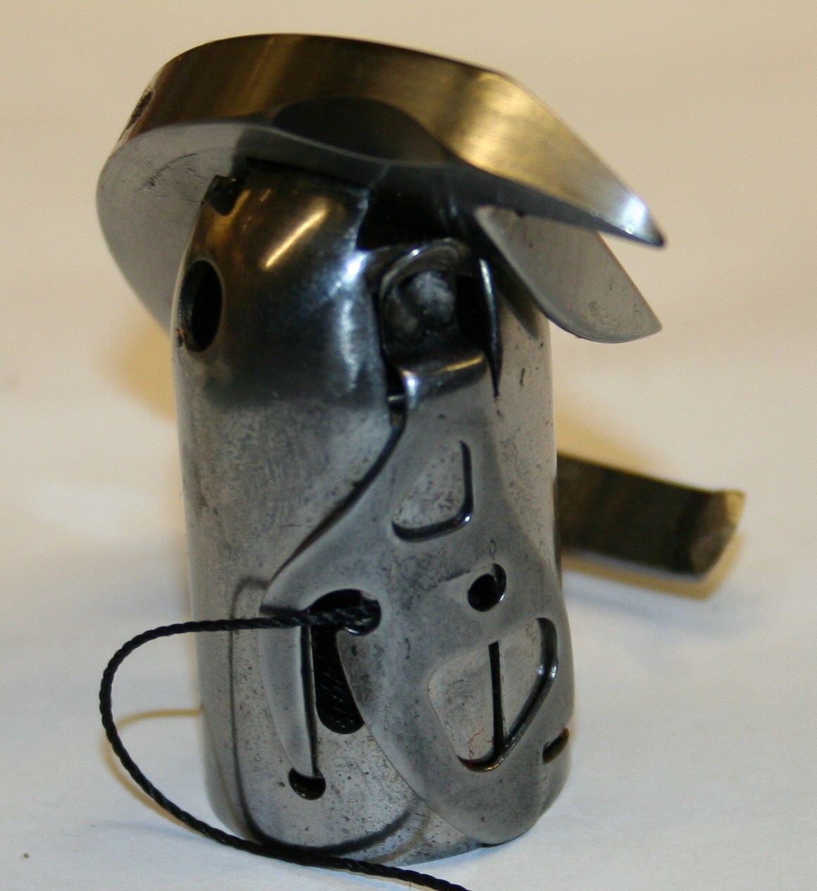

Adler 5-27 bobbin parts Do anyone know where I can get bobbin parts for my god old Adler class 5-27 sewing machine? I need the bobbin tension adjustment screw. The screw head is worn out and makes it difficult to adjust. I can also use a new tension spring for it, but the old still works. (see pics) I think it is the same bobbin house as in the Singer 45 K and in Adler class 105 and 104 (which is the successor to the class 5 and 4) Adler saddler class has two different diameters on the bob. adjustment screw 2 and 3 millimeter, mine are 2 mm. If anybody has these parts or know where to get it, please let me know. Trox
Hello All! Thanks for a great forum! I wonder if anyone knows where I can get bobbin parts for my god old Adler class 5-27 sewing machine. The bobbin tension adjustment screw head is worn out and makes it difficult to adjust. I can also use a new tension spring for it, but the old still works. (see pics) I think it is the same bobbin house as in the Singer 45 K and in Adler class 105 and 104 (which is the successor to the class 5 and 4) Adler saddler class ha two different diameters on the bob. adjustment screw 2 and 3 millimeter, mine are 2 mm. If anybody has these parts or know where to get it, please let me know. Trox
