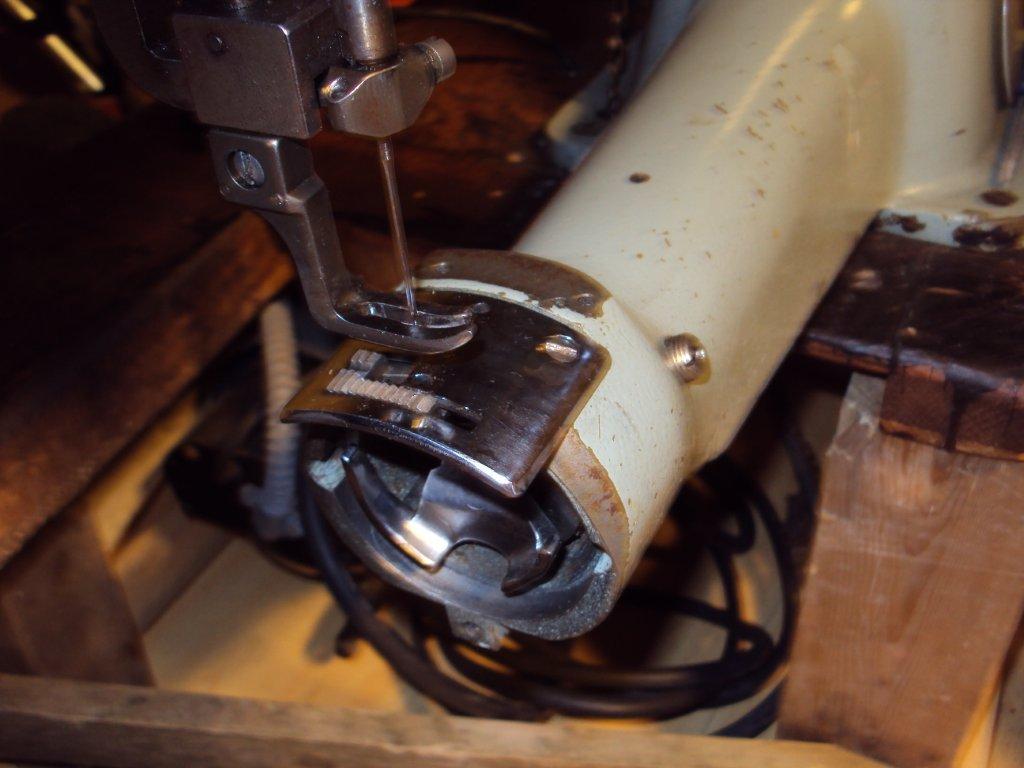

Thanks for your answer Bob, (345-H3-C6-LN ) You are right about almost all, but “N” stands for stitch length 6 mm not 4,5 mm. When the machine has only 4,5 mm stitch length it is marked with “4,5”. “C” stands for type C (not described any further) “L” for leather “6” stands for type of needle size a style of point. (What kind of needle, the part list does not tell). I found the partlist and the subclass part list on the web, but I still need the service manual. The machine comes from a closed down portfolio factory, they was making leather bags and such. I have gone over the machine, it is very good. No need for any new parts so far. The hook looks like new and every things seems tight. This is a medium duty machine, I have three big Adler’s for the heavy jobs. (A 5-27,a 204-64 and a 105-25) I am planning to trade them in and buy a Juki 441 or Adler 205-370 ( or a clone). The old machines do the job, but the triple feed is the best system. It is hard to get a clone like your Cowboy here in Norway, they only sell the Juki and Adler’s. I have been looking for a used medium size triple feed cylinder bed For a long time, I was lucky to find this. However, I cannot afford to break anything on it because of these spare parts prices. However, I believe there are aftermarket parts out there for this brand to? I know it is hooks and feet’s for sale, other parts I do not know of. Do you have anything for this machine? Trox -
Thanks Bob, It is subclass for leather the "L" in the name. I have just checked the subclass part list and there is an other model with a bit differet fed dog and plate that is for binding. But you are right it must only go that way on a binding machine. I just started a new topic about that subject, I want to set up this machine for leather binding. And looking for parts for an syncro binder. I will just set the feed dog a bit lower, in level with the plate and see if that works better. Please see my other topic about binder for it. Thanks Trox

Hi, I just purchased an old Pfaff 345-H3-6C-LN sewing machine. I wonder if any of our members knows this machine. I know this is a machine made for leather because of the “L” in the subclass name. The feed dog is adjusted to high and it is stopping the feed motion, because it is just moving in the same level. It is not moving down under the needle plate on its way forward. When I am trying to adjust it to do so, I cannot find it has any feeding mechanism. Is this supposed to be like this? Because it is a leather model? Should it just be lowered in level with the needle plate to move back and forth in the same level? I do not have any service manual, if anybody have one to share, (or for a similar model in an other brand) I be grateful for all help. In advance Thanks. Trox

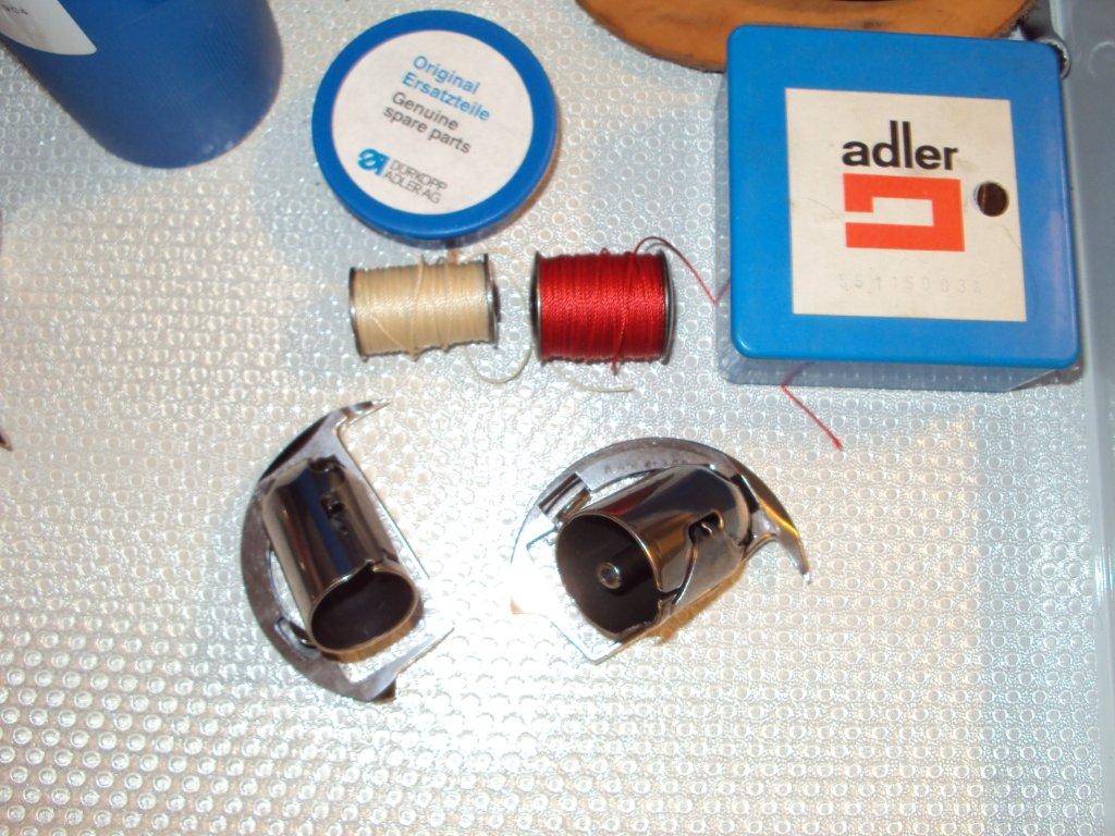

Everybody says Original Adler parts are too expensive, I do not think so. I just bought a new complete shuttle for my Adler 105 from Dürkopp Adler Norway. The price was the same as for an aftermarket shuttle from Hirose on EBay. 189$ here in Norway (one of the most expensive country in the world) this was a part stamped Dürkopp Adler. And thanks to the new blog I found the right shuttle for my obsolete Adler class 5-27, Dürkopp Adler still have shuttles for the old class 5 and class 4. You just need the right part number and I have those numbers. I am about to start a new topic about DA spare parts and part numbers for the old classes 105, 104 , 5 and 4 with all subclasses. I will inform you about missing part numbers and changes on machines that I know of there. Trox
