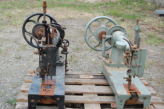

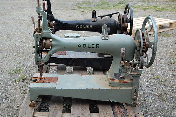

Hi Gregg, Kochs Adler used that gear drive on several old models. On old class 4 and 5. And on an older flat bed saddler machine too (it is maybe a class 3, I do not know). I guess I was wrong about the feed on the Adler 20`s, the black one has a walking foot (see the presser foot bar without a foot on, the green one also have a hole for a extra presser bar) Those Adler 20 machines are not good on leather, to big and clumsy feet’s. Trox A13.pdf

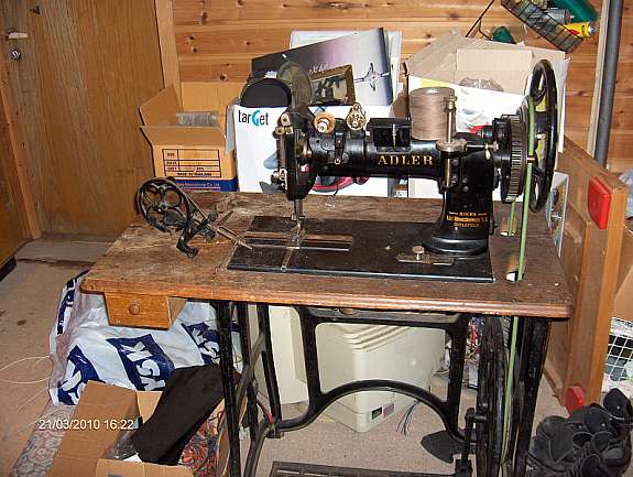

Hi Catskin, Great, I love to see a picture of that machine. My hobby is to rebuild big German machines, but mostly cylinder bed machines that I can use in my leatherwork. Here is some pictures of two Adler 20`s, that was offered me as garden decorations. They did not have the right feed (no waking foot), but they both had high lift. To much rust, and long drive made me leaving them to die. They had that special hand wheel gear you might like to have on your machine. Trox.
Hi Catskin, Your Adler 20-2 is normal lift version sewing up to 16 mm. with needle 794 u. The Adler 20 subclasses; 20-6a, A 20-7 (7a), A 20-8a has a lift on 40 mm, using the Schmetz 1000 H needle system. The successor the class 120 in now again made by a German company; SL-Spezialnaehmaschinenbau Limbach GmbH & Co. KG. On license from Dürkopp Adler, together with the famous Adler class 30 shoe repair machine. The Adler 120-30 is a real monster machine, sewing up to 26 mm thick. However, it cost more than a new Mercedes Benz. http://www.sl-spezial.de/sl/index.php/company.html Watch and enjoy. Trox
