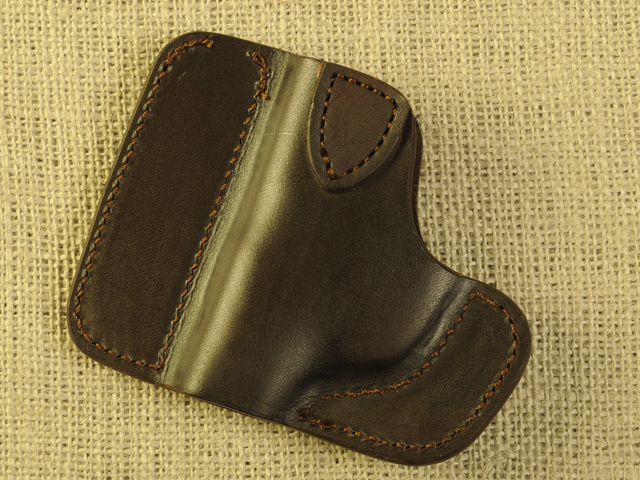

Here's my latest version of a front pocket holster for the Ruger LCP. The design includes a slot for the clip of a pocket knife and a thumb tab on the back. Jeff
