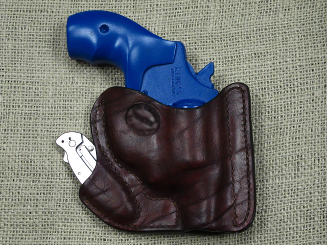

I carry way too much stuff in my pockets but I always want to have a handgun and a knife. This is my second design for a combination holster. Previously, I designed one for a LCP with a knife. This one is for a S&W J-Frame revolver and a Kershaw Chive.
