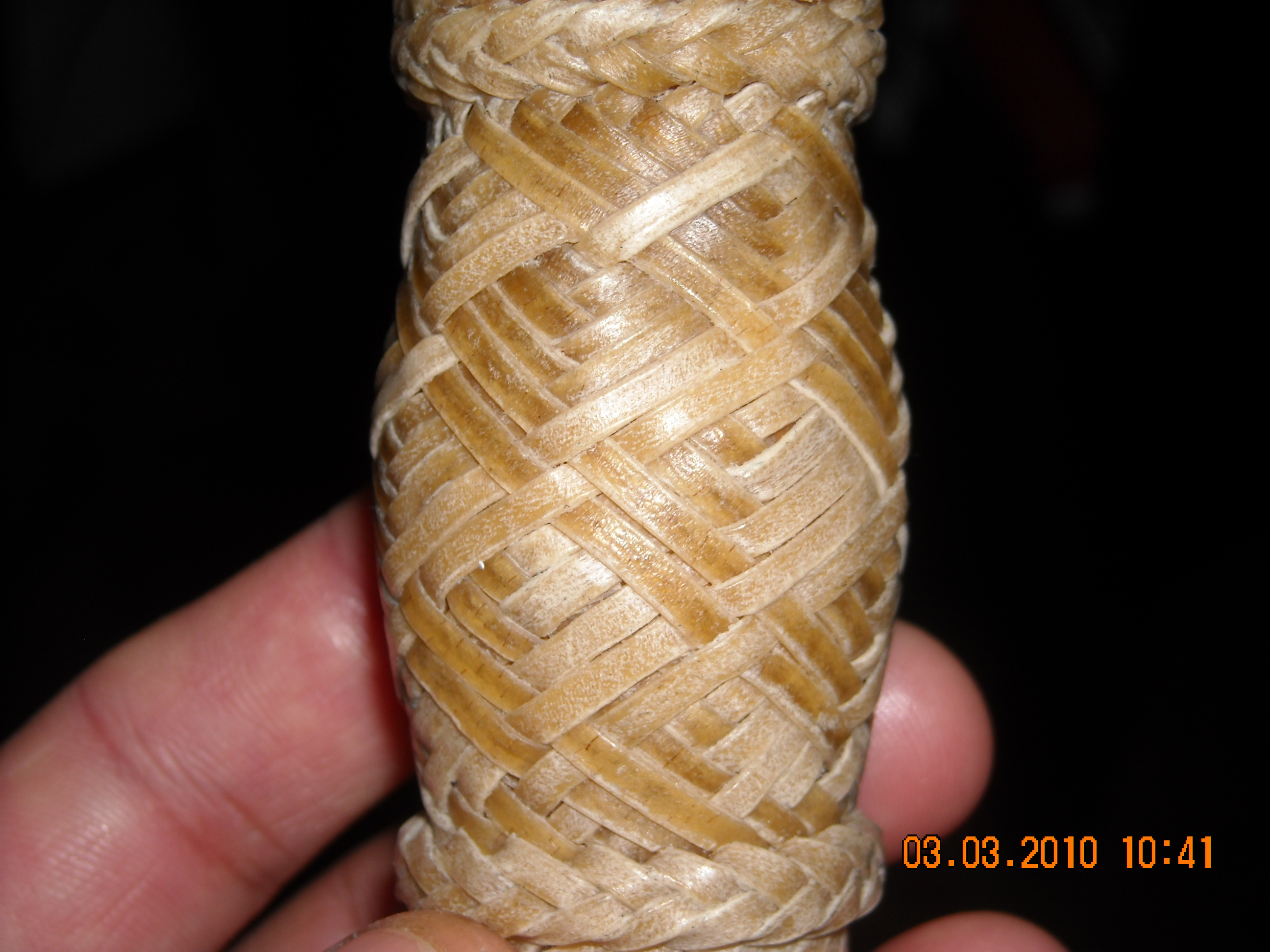

here is the pic of the second section. dont pay atention to how i set up for the pattern because that all depends on how it is started as you can see at the beggining after the ring knot it starts over two but in this section after the crown knots it starts right away u1 05 in the first string the rest of the passes for the first string is u4o4u1o4u1o4 the first and second pass differ by one and then the pattern is o4u1o4 the rest of the strings follow as i explained before the most important thing is to watch you rpattern rather than follow a run list, thats what i did keep in mind when you want to transition out it will change a bit and take some work t keep the pattern consistent and set up for the pattern change. take care sorry i cant explain more i dont have a run list that i followed i just developed it as i went. keep in mind that this is usually done on a more cylindrical object i was a bit ambitious to try and do it on this kind of shape, as it posses problems for the ground work wich take more attetntion to detail. it would be best to start out on strait cylinders. and progress from there. hope this helps if not give me a shout and i will respond as i get a chance. chek out the videos Knothead (Brian) posted on the other thread they are almost all done and his web site is great to look at also. take care.
thank you all for your feed back i am happy that ya'll like it and at least it will help me keep going. aggie the pattern starts off where the ring knot is located. and it starts off as over two (in that section )from their i am working in sets of five the first string goes o5u4o4u1o4u1o4u1 and the pattern is evident after that fot the first strand the second string goes u2(after the over 2 as all the rest will follow) o1u4, third 02u3 forth u3o3u2 fifth ou404u1 the pattern repeats its self as you go but basically the first string is key and always working in sets of five as you can see the overs and unders always add up to five so every over and under adds up to 5 after the first pass. the second section is better to observe than the beggining as the pattern was developed better as i worked it out i will try to post another pic so you can look at it better Jerry i think the quote is from Bruce Grant and thank you indeed for your comments. on the other hand like you say " this inspires" well comments like your and those of others along with my passion for the art is waht motivates me to keep going and getting better thanks and i'd like to see one of your whips when you can post one. i really do agree with the quote you mention, it has taken me a long time to get to where im at yet i think i can still improve alot. take care ya'll

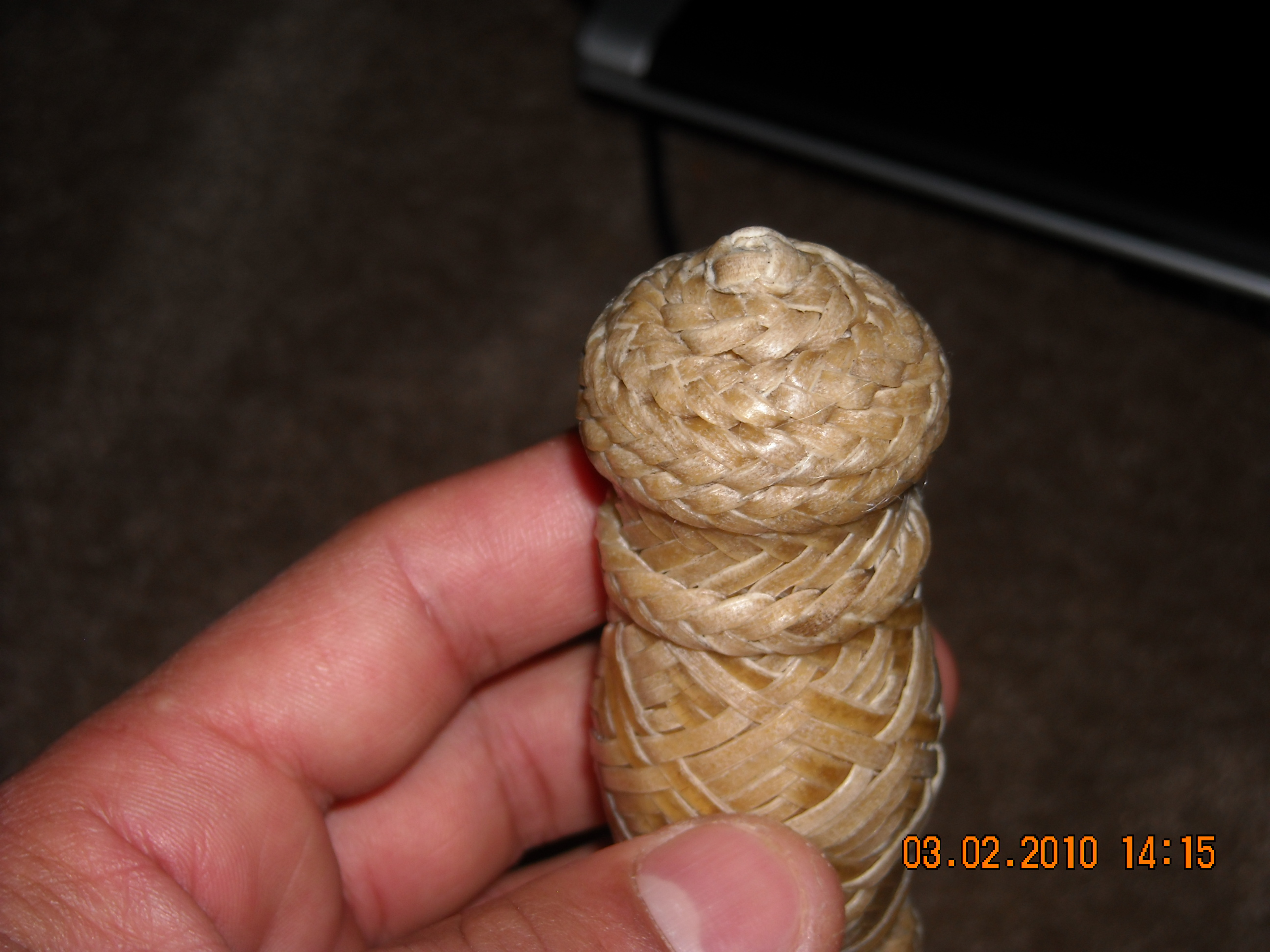

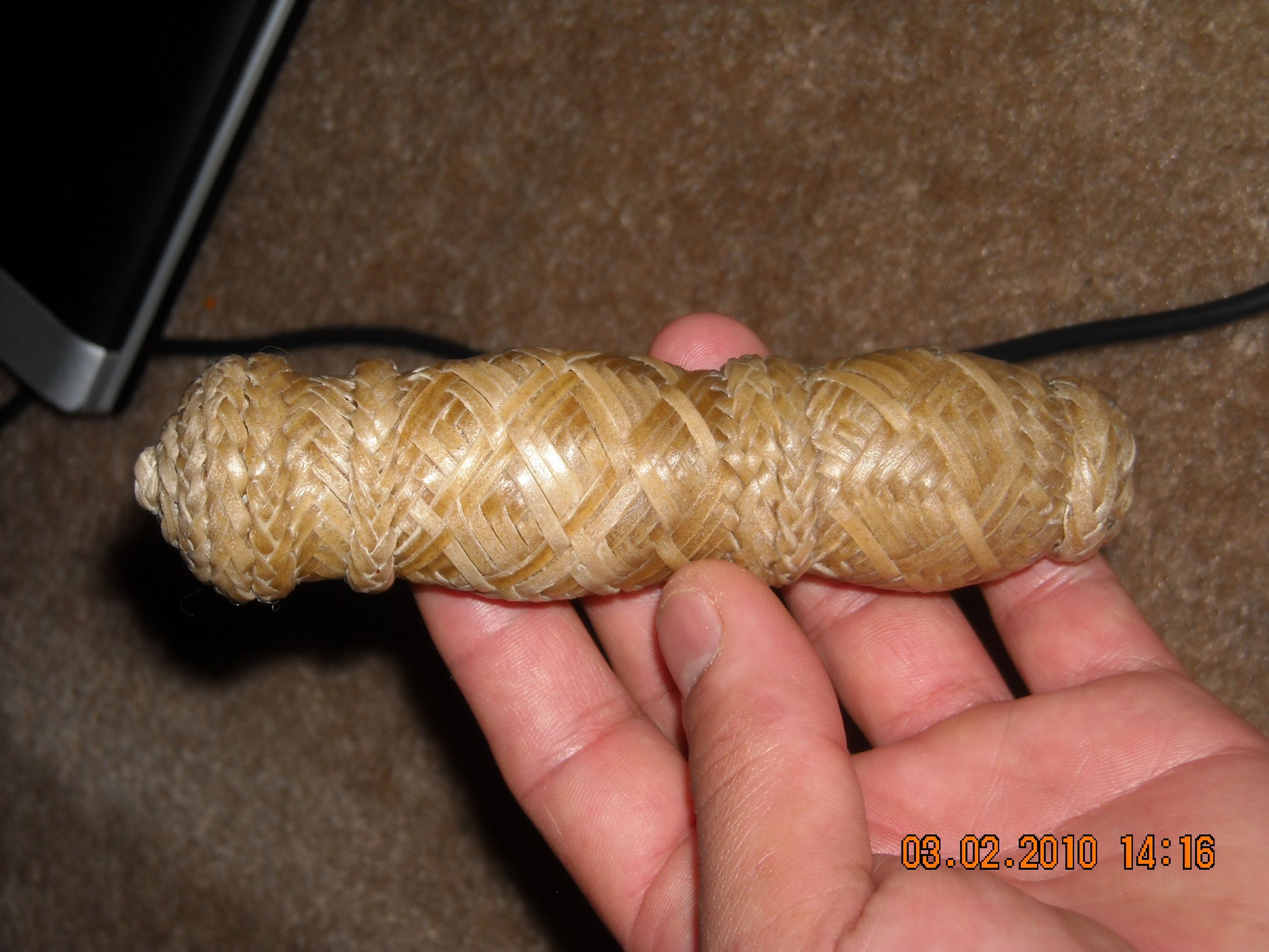

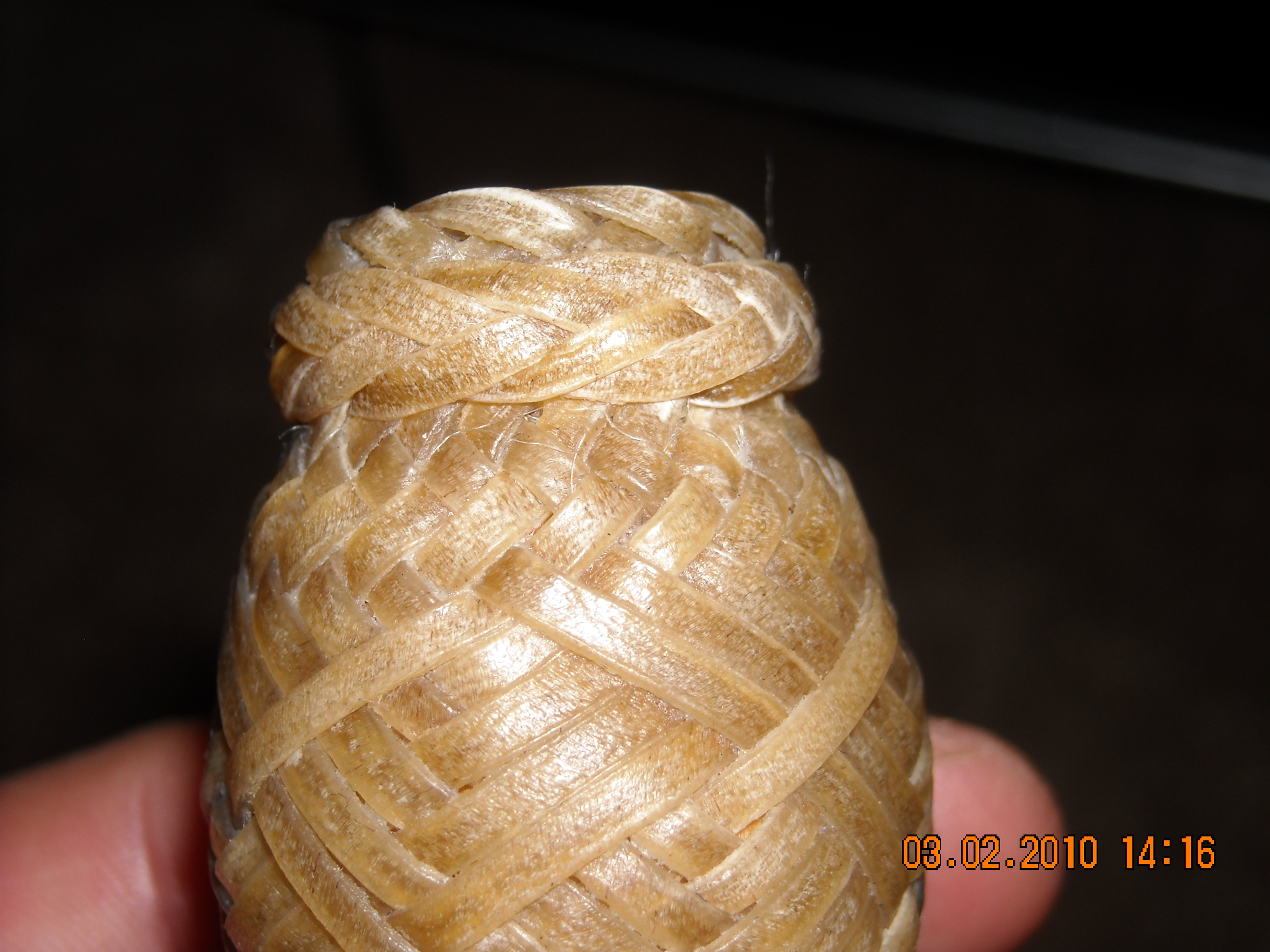

here is another handle i've been working on these last couple of days. i made it with 20 strands (40 total) of horse rawhide. i can see alot of things i could have done better mainly because i made it and i am very critical of my own work but lets see what ya'll think? the pattern is a modification of made to a similar one i saw in a book any way here it is.

thanks you every one for the comments. this kind of work is not really that hard as far as the fid work. the prep is what takes most of the time and setting up the lace takes a little patience to lay down the ground work. after the ground work is done making the developing the pattern is not to difficult, the pattern just depends on you. Brian is working on something fro you guys that you will like. take care
thanks ya'll but Brian is the mastermind behind this it was his idea. he gave me a dowel and a piece of goat rawhide so i carved it out and shaped it with my dremmel later i cut some lace and got started. he made me do it !! thanks for posting it also. it is a handle for a fid with "fidwork" on it. take care. some specs. 18 1/8" wide laces. not to manny but it worked.
