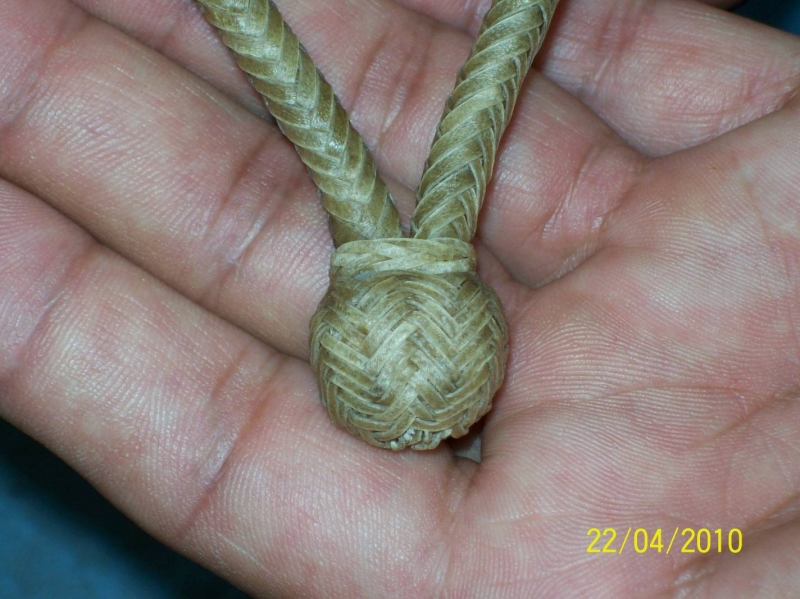

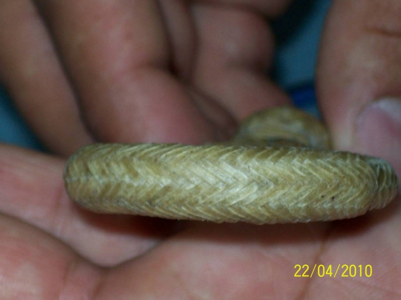

thanks for the comments everyone MEGABIT it took me alot less time to do this one but dressing all the knots took some patience cause they were all so small. the body is twelve strand the heall and the nose are four pass. hoo and the nose button is not a multi string knot i mae along TH and then interwove it to 4pass with one long continuous string so patience was key for me. take care yall.
well lately i have been working on some really small stuff, Brian is to blame for this. ive been working with the horse raw hide i got a while back and been taking advantage of the thin parts. this little bosal was a spur of the moment thing but it came out really nice i think. it has room for improvement as always but over all i like it. any suggestions and critiques are always welcome, take care ya'll
