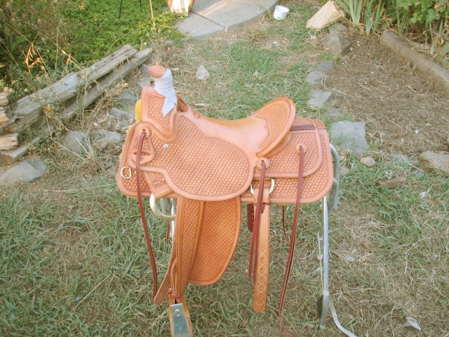

  11. I just got the oil set on this saddle.Ring rigged 3/b,small square skirts,no.4 dally horn 3"cap.She wanted this arrow basket stamp.The cantle is 4" high,10.5" wide and 1"dish

  22. Here is an exanple.We spread the bars to 6.26x8" the rest is what the customer wanted
  23. the way I read the rules is says no thing back of 5\8. the gullet 5 3/4 x 9" ,14" wide fork,5" cantle,2" dish.

  25. This is a single 5/8s flat plate.latigo wrapped No.5 dally horn,5" cantle with pointed skirts
