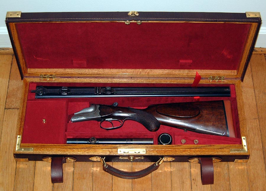

Send some photos of what you have in mind. I get brass parts made out of investment castings for my own business, which is high-end oak-and-leather double rifle and shotgun fitted cases. I have to make my own because the old brass hardware makers were driven out of business by the Chinese. My caster can do copper. Q: Which alloy? Pure copper is VERY soft (as you know). There are some very high copper alloys that are much better for parts that will be subjected to stress, like clasps, D Rings, buckles, etc. that need resistance to bending. Check out the alloys and see what you might need. Mos are 80% or better pure copper and look and "weather" identicaly, but won't bend or break unexpectedly. TANDY: and anyone else that is importing "hardware" from China: I know EXACTLY what you are talking about. They use zinc castings, made in metal permanent moulds in high speed casting machines. I once worked making and repairing the metal moulds these machines utilize. To the Chinese suppliers, all "metal" is the same, and "Brass" describes a color, not a material. Most of this hardware is designed to accomodate the "fad and fashon" driven market, and is only expected to hold up a month or two till the next fad hits. Most of is dirt cheap, too. After 2-3 months of use, you can tell it, too. Google up "Alibaba" and search for handbag hardware. Interesting......sad, but interesting.

Actually, the type I need is like the ones above. They are in the center of the case; just under the handles. Unlock, they function as a pushbutton catch. Insert key, they secure the case (at least from "honest folks".) I need 50 or so. If they are not available, I'd like to buy an old one for copying. Heck, I'll even buy the case for one. I build and repair oak-and-leather cases, so I'm familiar with Abbey and the beautiful Liston Flip Catches. I use them and admire the craftsmanship. I just haven't gotten one of this type in a very long time; should have copied one when I had the last one in the shop. Campchair
