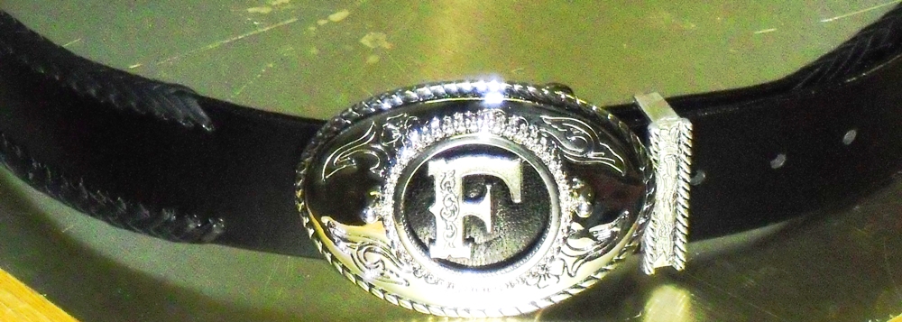

I decided to spend my Christmas morning doing my favorite thing. Doing some braiding. Started this last night and finished it this morning. Compressed 1 to 5 start, 1 to 7 edge braid, Compressed 1 to 5 finish. The lace size is about a 1.2mm to a 1.3mm... B...
The belt is now completed and ready for gift wrapping. Tomorrow it goes out to the person receiving it. B...

I wont know about the wearing in part until I have it done and my Pastor has it around his waste. Then I'll check on it in 6 months to see where it is and how it is wearing in. I still have side two to do yet. But it's getting there. It's not a modified basket weave, or the mexican basket weave. It's a 1 to 7 Fast Back Edge braid modified from Ron Edwards original 1 to 8 with compressed ending of a 1 to 5 that I got from my friend Enrique Capone. My braiding mentor wrote the article on the 1 to 7 in the whip makers association publication about a couple of years ago. I got one of the original prints from my mentor. B...
I been working on a belt for my Pastor. The actual buckle will not be in till Thursday or so. Hopefully I can get side two done before it gets here. This belt is a 1 1/2 inch width and 46 inches long. Whew! B...
