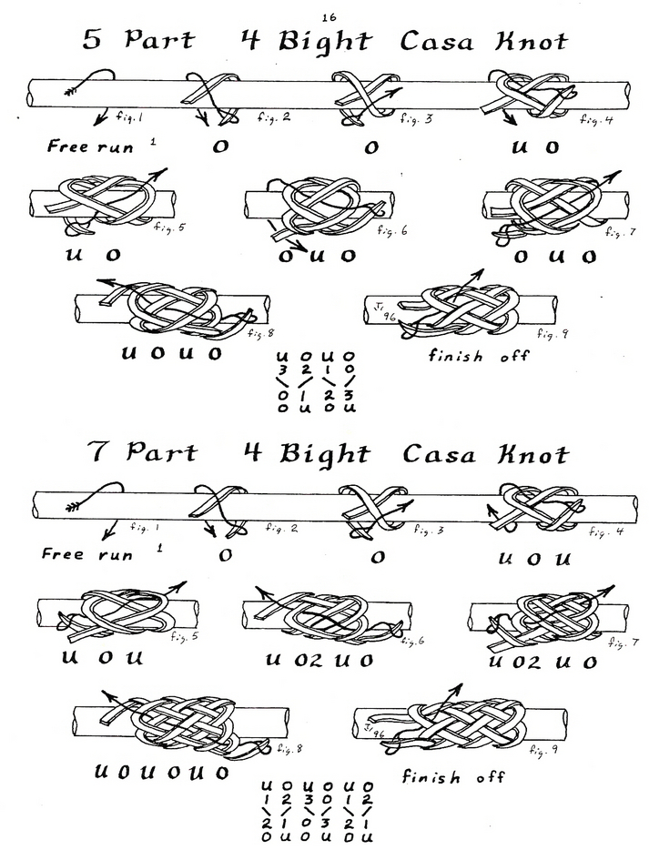

Entiendo. I have no idea which end you're trying to close up. But either way you go you'll need a nested bight knot. This allows for 4,6,8 bight knots to close up. Much like a globe knot does. I have included a grid image example below to show you what I mean by nested bights. The above grid is just an example knot. This is not one to be tied. Brian...
