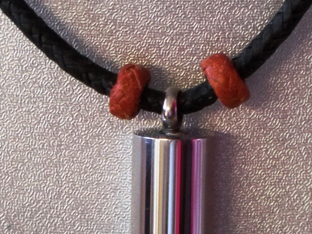

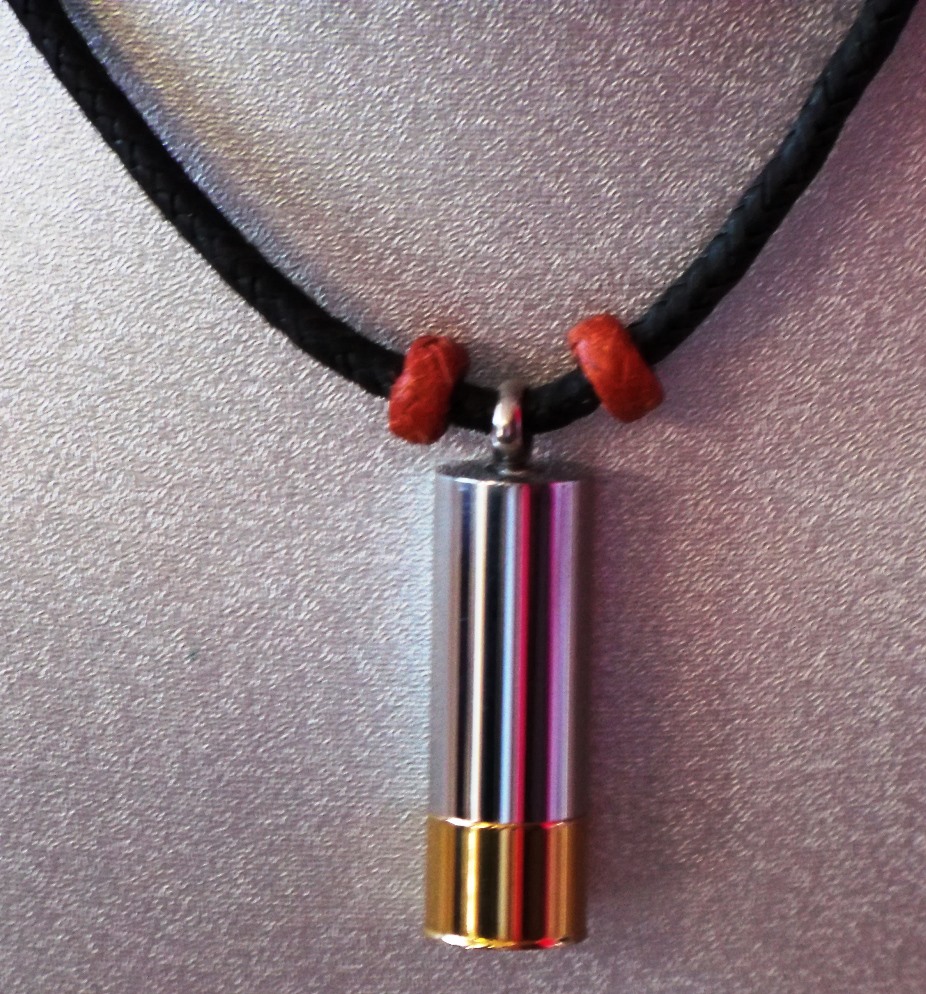

  18. This one was a special project. 18 inch necklace in Kangaroo lace. 8 plait black - Under 2, Over 2. 2 - 3 pass spanish ring knots. Brian...

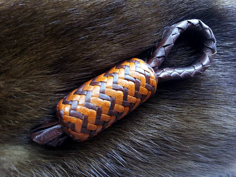

  19. KnotHead
    A Key Fob
    Well thank you Peter T. Brian...
  20. KnotHead
    A Key Fob
    Well. The key fob made it to my new found friend in Florida. She takes a much better photo of it than I do. Brian...
