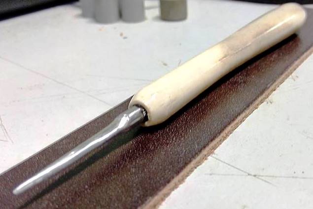

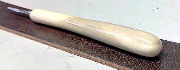

  2. It's made from an old firing pin.
  3. This is about 51/4 inches long. Deer antler bone handle.
  4. Yes.

  9. I use saddle soap to dampen the hide with. I spread it on there and let it sit for about 20mins. Ends up perfect that way. In some cases you can cut it dry. But it is not a recommendation I would make. You can cut it as wide or as thin as you want to or are skilled enough to do. I would make a doughnut cutter similar to the type used by the Argentines. I use several of them that are preset with the different sizes I want to cut lace at. Simple to make with a 1inch wooden dowel. Cut 1/2 inch piece off. Knock a centered hole into it at about 5/8ths and find your stanley utility blades and grind one of those down at an angle to pressure fit the blade into the center hole. Next you'll want to take your hand saw and cut a slit half way down the doughnut. To widen the slot I use a set of jewelers files and sand paper so that I can use a drill bit to measure the width I want to cut the lace at. Give it test and if that's got it. Take the whole thing to a bench vise and flip it over so that the bottom is facing up and use a light tap to put the blade in place more permanently. To replace the blade just tap it out. Brian..

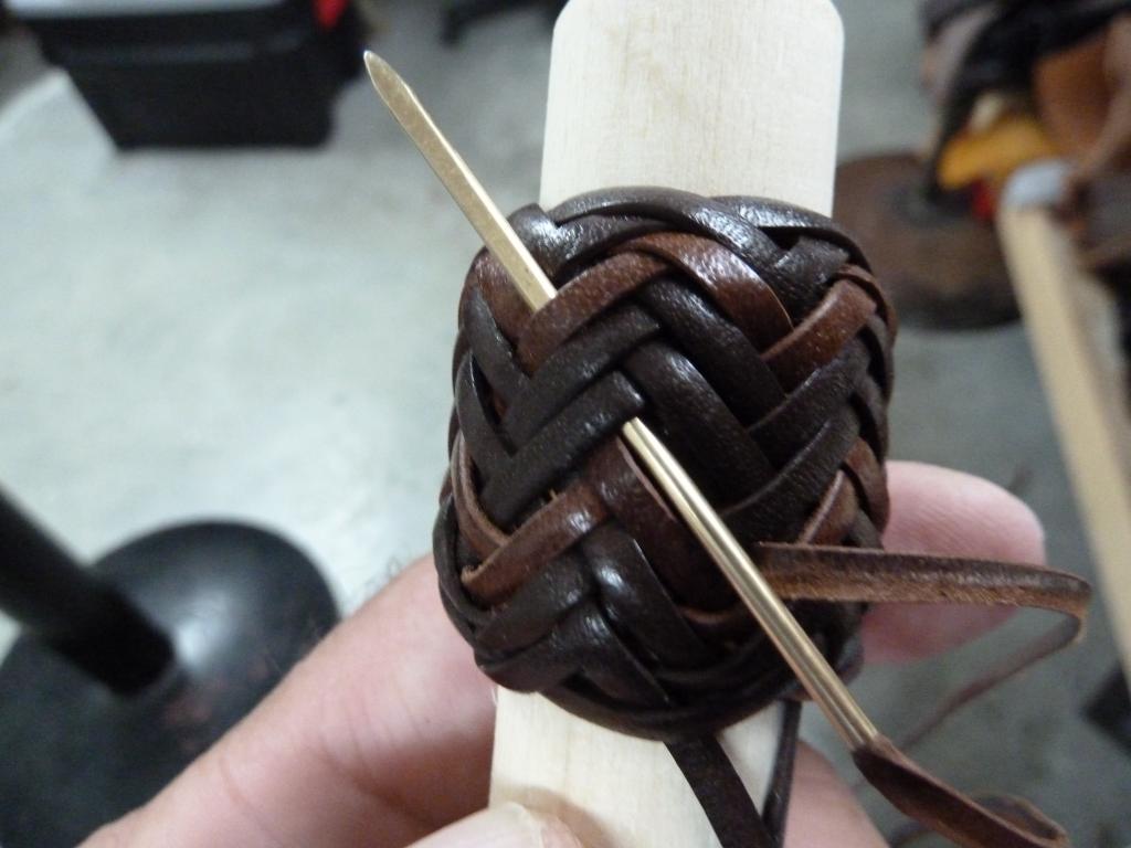

  10. 1. 4 strand round braid makes the loop end. 2. Transition to an 8 strand round braid for the main body of the braid. 3. That button knot looks like an Aztec button knot. Brian...

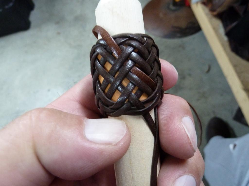

  12. That should help you out. You're just doing a smaller interweave is all. Brian...

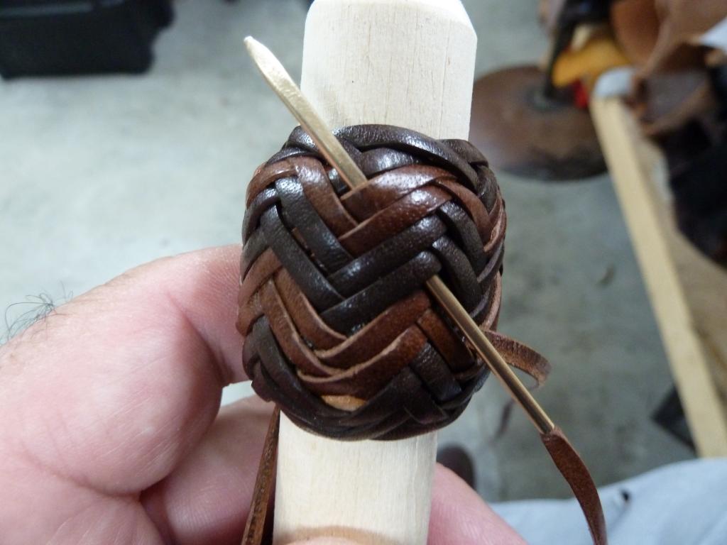

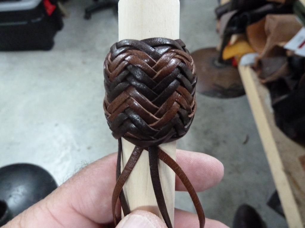

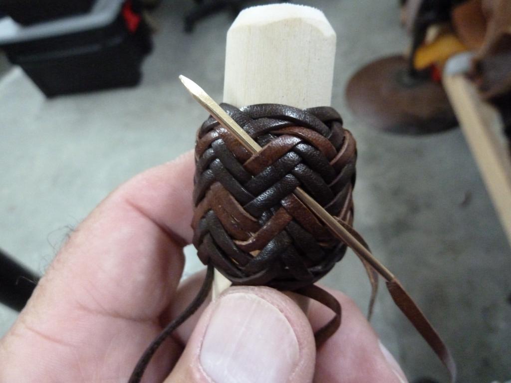

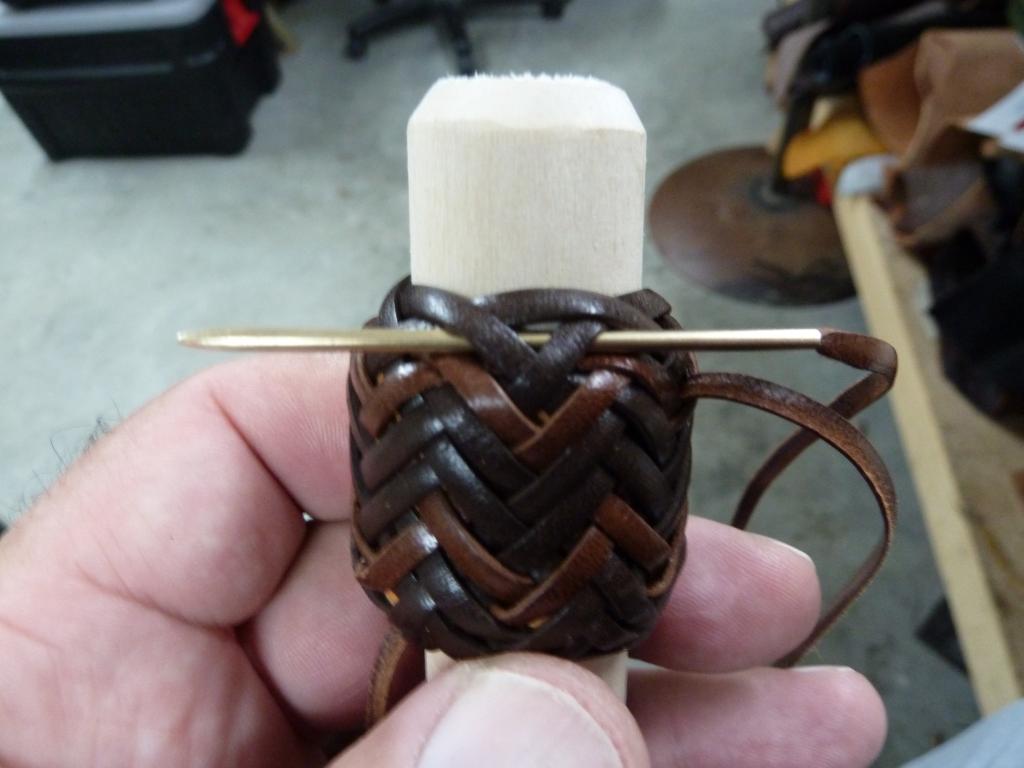

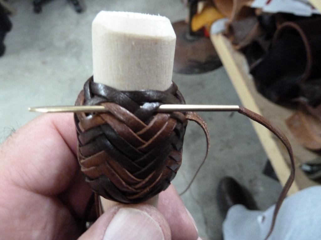

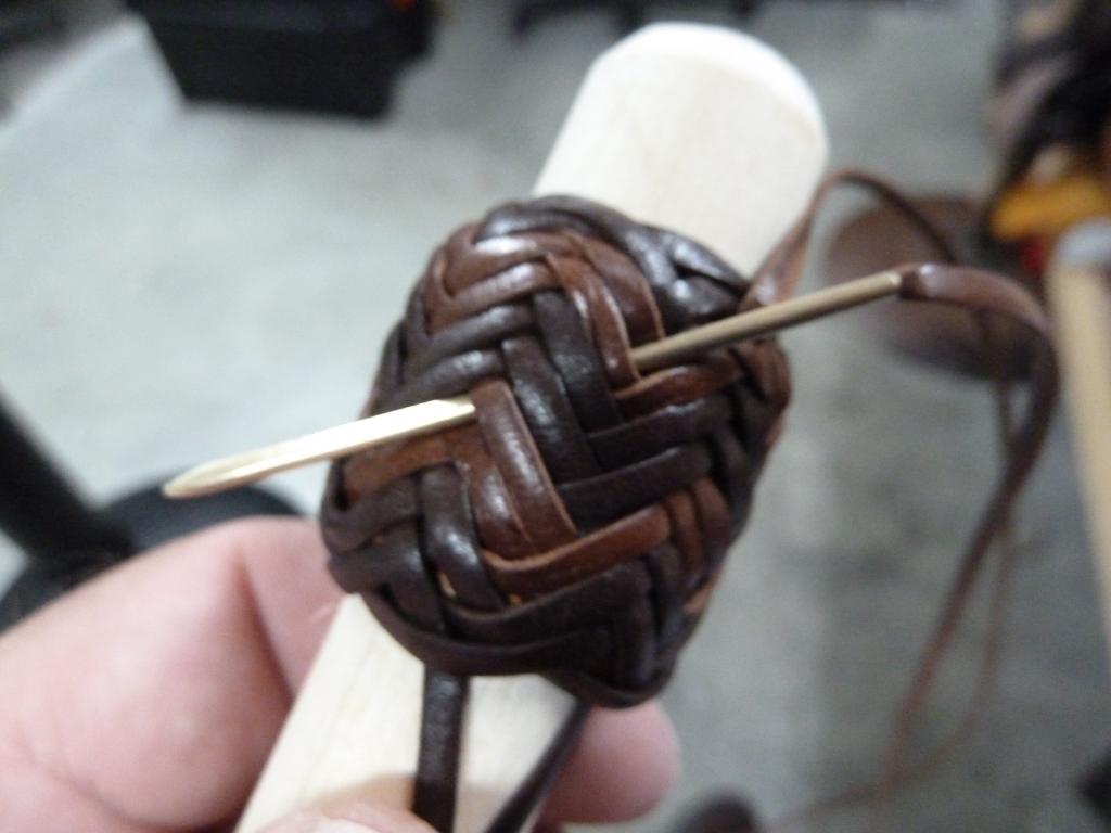

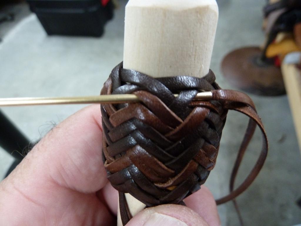

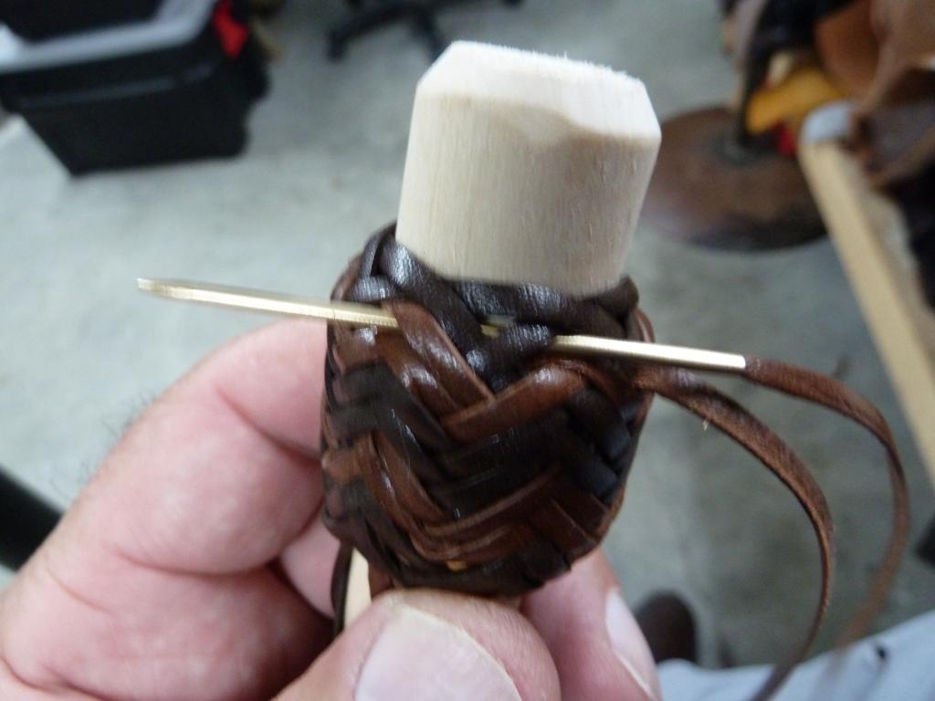

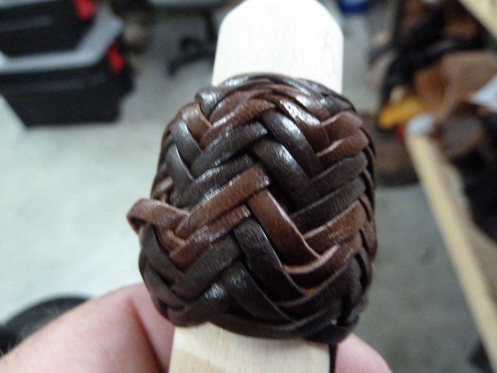

  14. Okay this tutorial is by Brett Haskett. It will take at least two posts. Post 1.

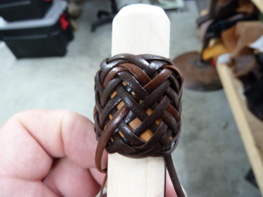

  15. Are you trying to work a 5part 4bight casa knot with a 3pass pineapple interweave? If so, I just uploaded a tutorial done by my good friend bud brewer whom is now long since passed. It's a pdf showing how to do the interweave to a 5part 4bight turks head. Buds basic pineapple Knot.pdf Brian...
  16. This pdf file will help you. http://s000.tinyupload.com/?file_id=51355314563382013929 I had to use an file host for this one. The file was too large to upload here. The tutorial is by Brett Hasket. Brian...
