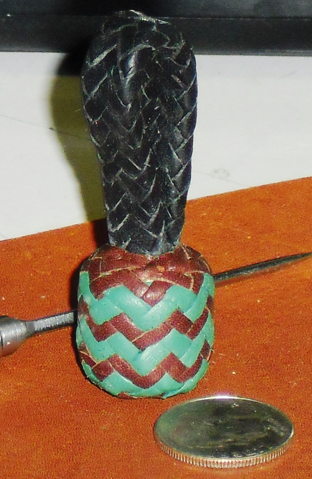

Just doin a bit of playin around. This key fob has the traditional trenza de doce braid with the iris knot. 13parts by 8 bights with an Over 2 on top and an Over 3 on bottom. Brian...

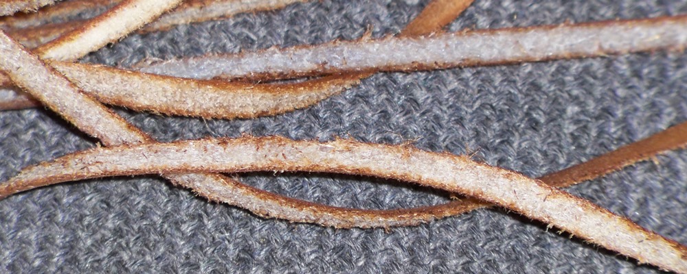

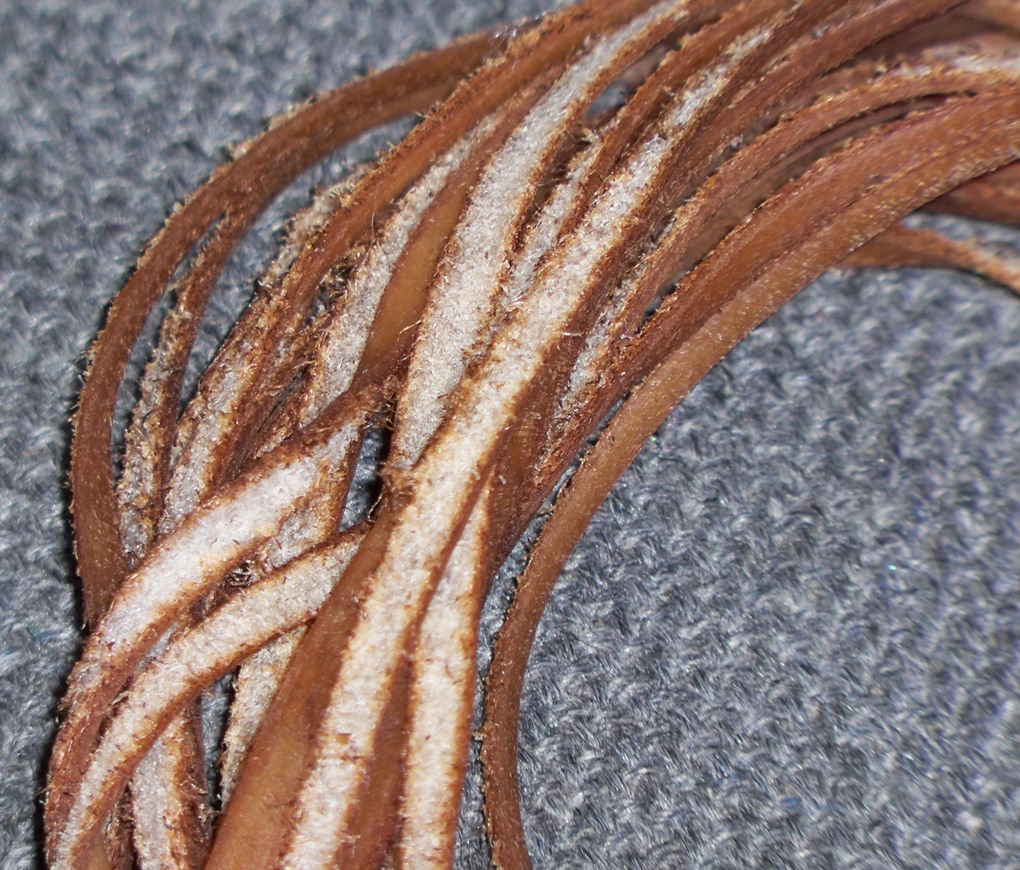

I think I'll stick with the color that I got on this. I kinda like it and it will pop with the natural against it. Take a gander at the dyed lace. Natural The Columbian Coffee as dark as I could get it. (STRONG TOO) LOL... After 24hrs in the container. Brian...
