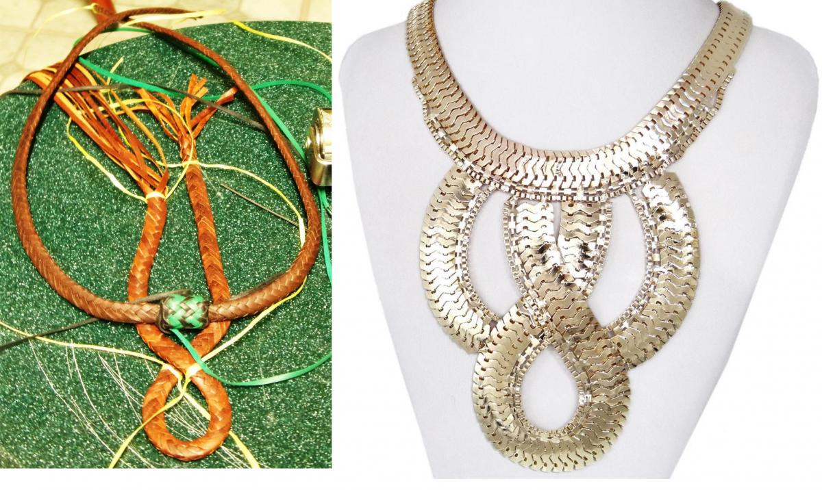

Got me an idea brewing. Only 4 more things to do. What do you think so far? The necklace braid is a modified whip makers plait. The pendant part is another modified whip makers plait with 2 transitions in the braiding. This should be interesting to see if I can actually finish it off and still make it look pretty. LOL... This is what happens when I'm left alone with my leather for too long. LOL... Brian...

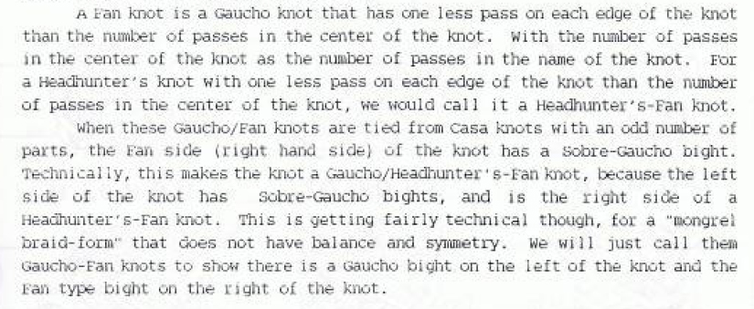

A 5 part 4 bight base knot - 4 bight is divisible twice. A 7 part 6 bight base knot - 6 bights is divisible 3 times. A single string version of the gaucho will work on the second one quite well. Gauchos are dependent on the bights being of an even number or the numbers being of an even type value. I have only encountered this once or twice and only because my braiding mentor brought it to my attention some years ago. So I had conducted a little bit of research into that matter. The 7part 6bight base casa knot seems to be the most popular with this simply because people tend to tie this knot more often than not. It's been some years ago that I worked on this research and the data is some where on one of my hard drives. Of course this will take some digging through about 10 hard drives. Gaucho Knots - Quoted from Tom Hall (Introduction to Turks Heads) page 127 " Gaucho knots are regular cylindrical flat braids with a constant column coding throughout the knot. It must have gaucho bights on each edge of the knot. Gaucho Fan Knots - Again from Tom Hall's book (Introduction to Turks Heads) page 125. I am hoping that this helps out. Brian...
Mathematically that will not work. Simply because the 7x6 is both row and column coded. Brian...
