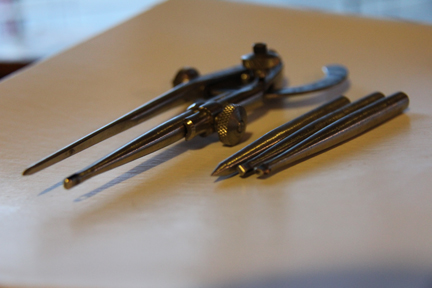

This is a like new CS osborne scratch compass. Brand new condition. Only been used 3 or 4 times on the smallest blade. The other blades haven't been touched. Only had it for less than 6 months. It's been stored in a protective case. I'm asking 60 plus 4.99 for shipping. Thanks.

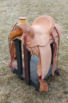

Had a lot of fun with this saddle. Starting to get the hang of it. 15.5 inch Lieuallen on a Timberline tree. Thanks everyone for your help in the forums.
