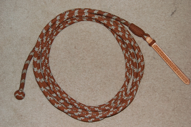

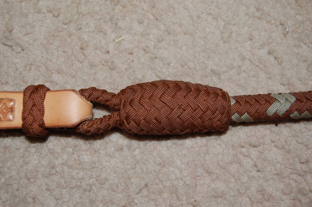

Howdy everyone, Here are some pics of a mecate I finished tonight for MarkB. They are 12 plait, and just a hair over 1/2". Mark made the popper himself. I tried to attach a horsehair tassle to the pineapple knot, but couldnt get it to work right and had already cut the strands off flush or I would have run them out through the knot to make a tassle. Let me know what you think and I am open to critiques as always. Have a good one, CW
