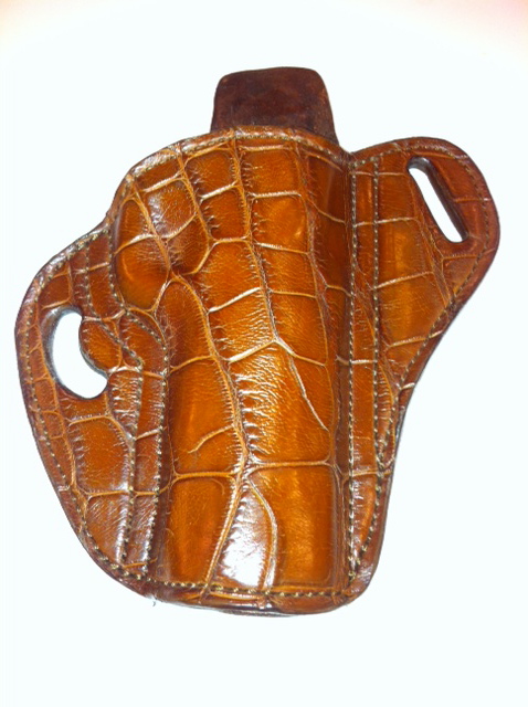

Not sure what you are referring to on the "stitch line being way off". Any time you are using a 3-5oz exotic that covers 7-8oz veg tanned the 90 deg curve stitching right below the trigger guard can not be as close as if it were only 7-8oz veg tan. Gator in particular can vary in thickness depending on the length of the hide. For example a 10 foot hide may be 5-6oz. If the tannerery makes it any thinner they run the risk of cutting holes in between the scales since they are larger and much more pronounced. 4-6 foot gator hides are usually 3-4 oz. The veg tan below is molded tightly to the contours of the 1911. Is that what you are referring to? -

The more I use gator the more I like it. Ever so unique. I normally don't use conchos on OWB rigs but this one seems to fit and not one you can buy at any tandy store. We'll see if it helps it sell!

These came from the tannery with a nice natural sheen. Needed nothing but a little natural wax and a buffing wheel. Tanneries have different finishes for Gator. One of them is a high gloss called glazed. This is not glazed. However glazed gator is beautiful. Many belts and wallets are finished in glazed. -
