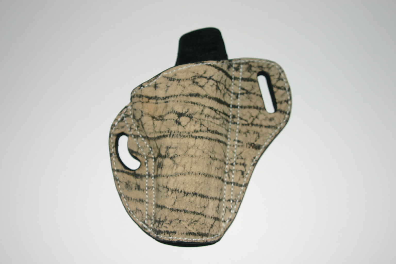

Yes, cut out, skive the edges, glue then stitch. On the ostrich, since is is considerably thinner, I took the cut out skived the edges and glued it back in its original place so the ostrich would "dome" then stitch. I also use #69 thread on the inlay I felt like the inlay should be thinner than the #277 I use on the rest of the holster. (opinion only, both obviously work) Thanks, Rob -
I thought I would share my first few tries at inlay overlay. I was fortunate to get some tips from the famed "Randy and Claudia" who live nearby. They are true inlay artists! This is a simple star pattern but I may elaborate later with more details and pieces if I think they would ever sell. They are a fun change of pace and indeed unique. First is black shark with brown shark inlay. Second is black elephant with brandy ostrich inlay. Feel free to leave a comment good bad or indifferent. Also share an inlay on a holster you have made so I can get more ideas to try! Happy new year! Rob

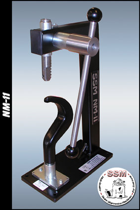

The one pictured is clearly a new one. I saw an old similar cast iron one awhile back and hoped I could find one like it. I really want the shoe "horn" version of this type of machine. (That curved hook) They were typically found in old shoe shops. Dust off that old bench top riveter and sell it to me!
