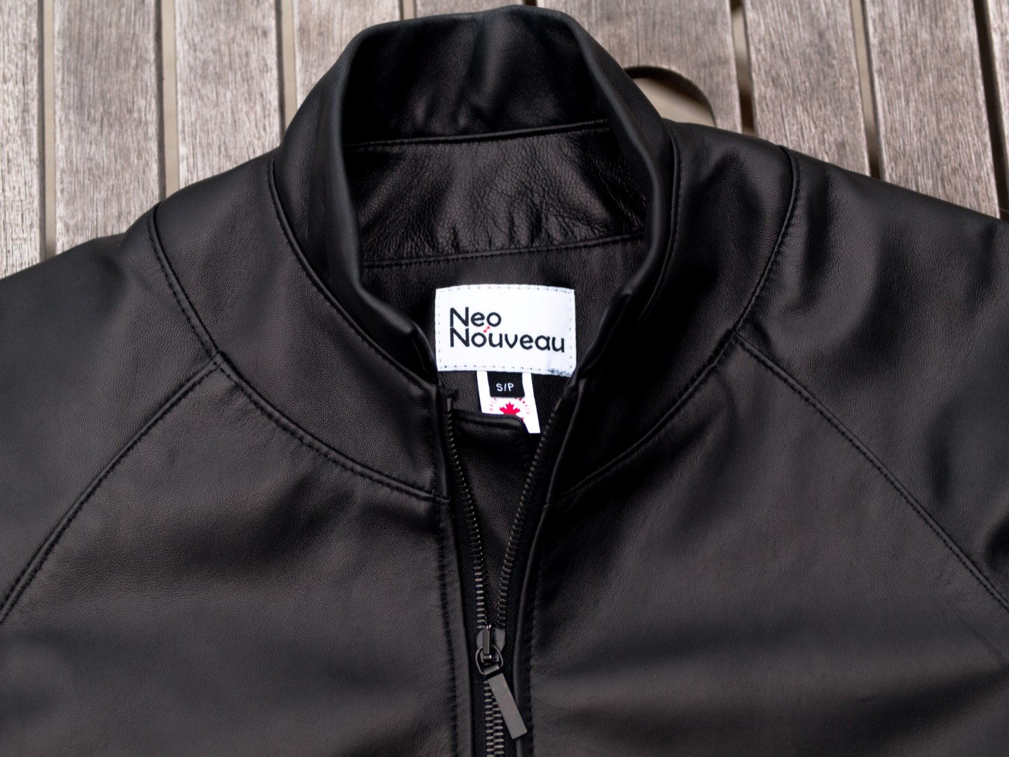

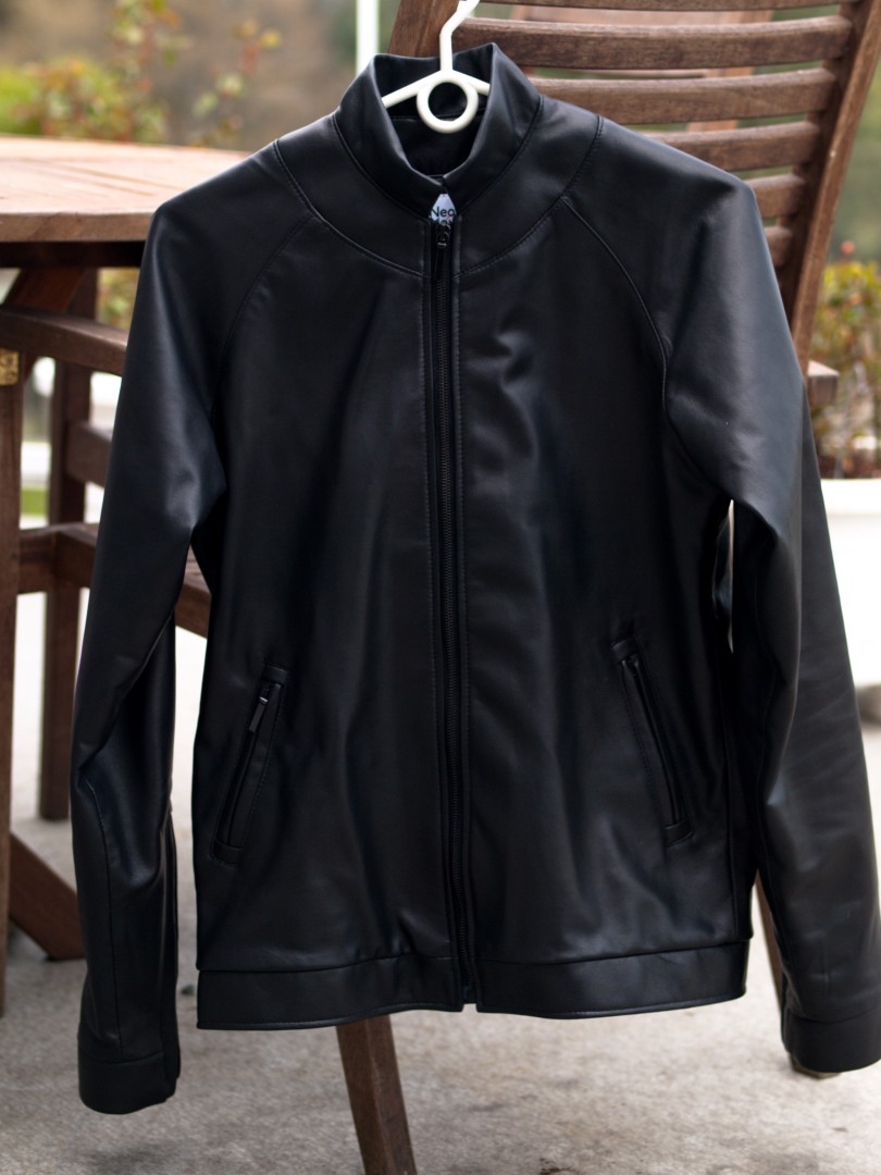

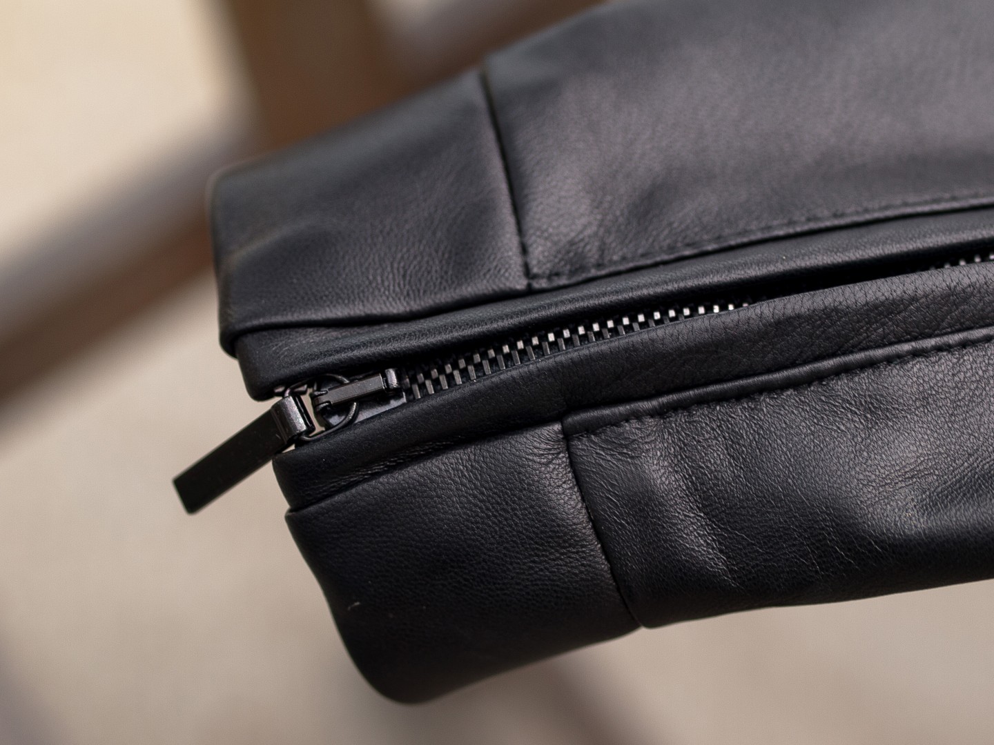

While I love this forum, I don't post nearly as much as I like to. I've also noticed that most of the userbase discusses and posts leatherwork related to saddlery, generally heavier weight leathers, and hand-stamped/decorated crafting. While I do some of this, I'd also like to share a few pictures of a jacket I'm launching in my first collection this year. While I didn't do the sewing myself, I can proudly say it's all made here in Canada through a factory of skilled workers who have done a great job. Leather is Italian lamb, with an acetate lining and Lampo zippers. Enjoy!
