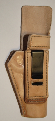

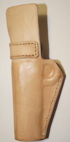

M1911 Tuckable Iwb
Deanimator replied to Deanimator's topic in Gun Holsters, Rifle Slings and Knife Sheathes
I didn't think of that. I'll give that a try before I resort to something like emery paper. Thanks. -
Finished sewing and molding this afternoon. Actually finished my first roll of thread making this one. It was TIGHT before I wet molded it, and that was with a Norinco with small sights! After the molding, my ball gun with Bomar sights fit perfectly. I'll let it dry a day or two and then dye it. The Eco Flo glue I used on the reinforcement ran a little. I wiped it up right away, but where it ran appears to repel water. I figure that'll affect the dye. Any suggestions? Thanks.
