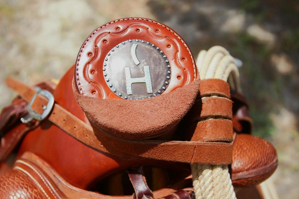

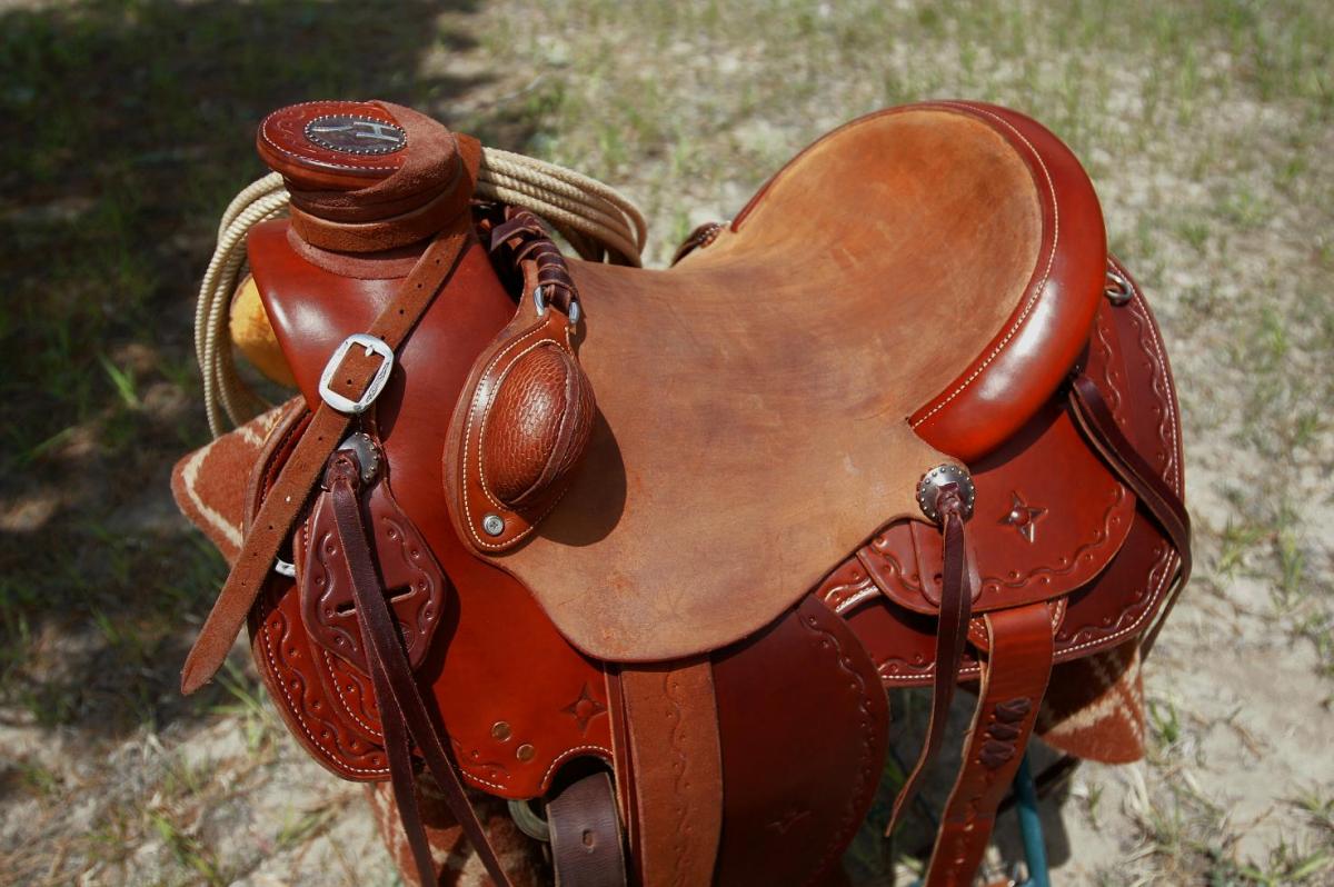

Thank you Joel. The tree was byJon W.----- it is one of his fiberglass and epoxy incased wades with 93 degree bars with 4 inch hand holds, 4 inch cantle and 16 inch seat . Saddle was just a little wide for this colt, but starting a colt in a new saddle was not the best choice. The fleece needed sometime to compress. Most of the four days where spent doing ground work with two short rides. Conchos are by a fellow named Gordy Alderson in Tucson. WC leather Tin seat this time, did it like Dale Harwood in his DVD accept without his skill The rigging/fork cover was challenging! Lots of leather if I messed it up ( got lucky ) went on straight true and even and pulled down tight. Not a real traditional look for a Wade but just had to get this idea on a build out of my system. Back Billets are temporary until I finish sewing the pair that I will put on final, the ones in the pictures are single ply just done quickly so I could get this horse started. Regards Billy
Finally made a saddle for myself My sewing machine went postal, so I did this saddle one stitch at a time by hand. Sewing skirts by hand is quite the project. When I took these pictures I had just finished 4 days of starting a colt. The Front Rigging, Back rigging and Fork cover are all out of 2 peices of leather laminated and sewed to make a Flat Plate rigging. Critique is always welcome, Thanx Billy .
