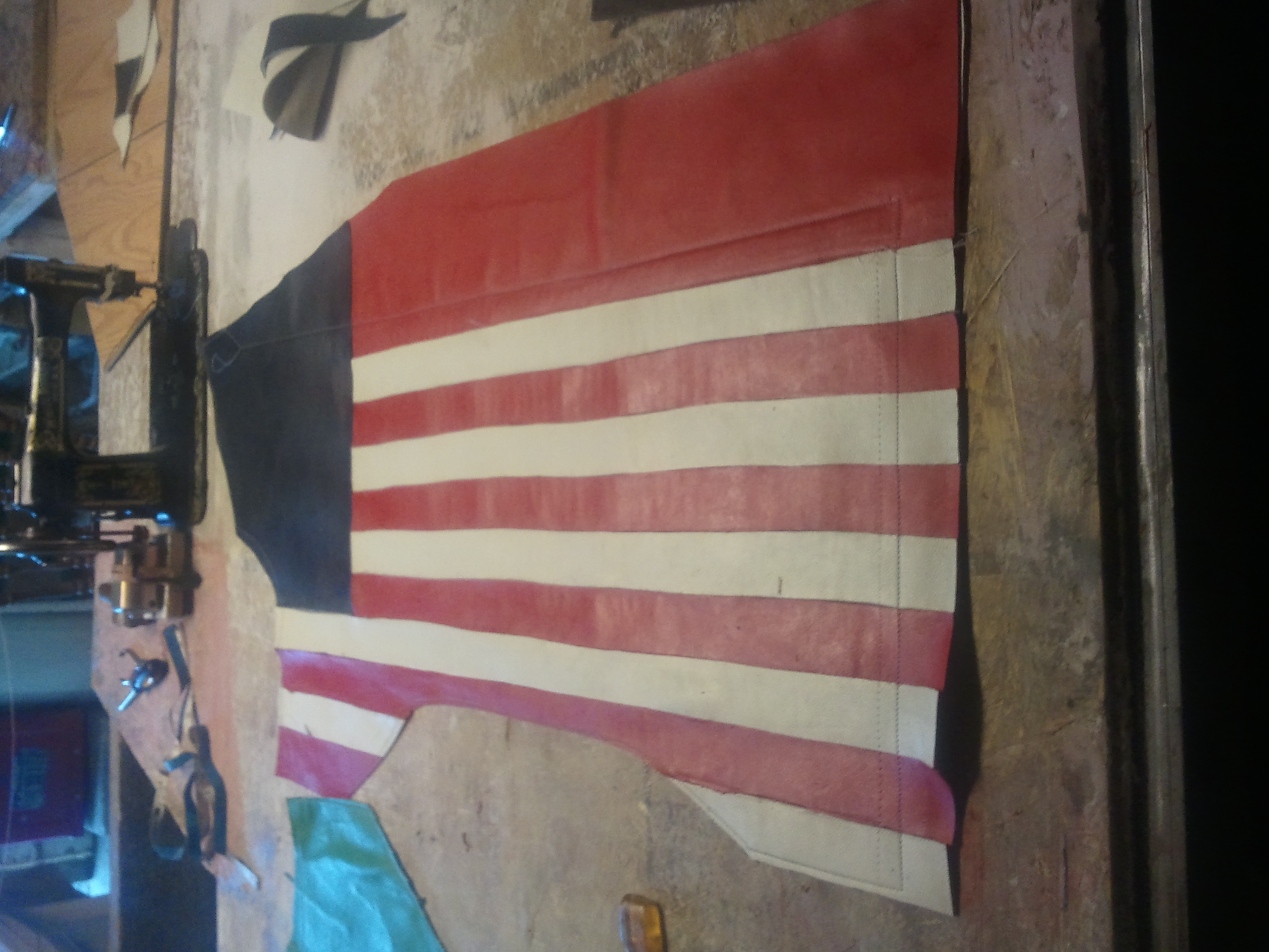

Ok folks here's. An open subject. I'm building a set of bullriding chaps that are american flag on one leg mexican flag on the other. Got the strips cut out and now need to get started on em and wantedb opinions on how to put em together. Skive and Overlay the seams or lay em edge to edge and use a backing down the seams. Weight of course is an issue and didn't wanna zig zag stich just wouldn't look right I don't think. What ya think thanks for all responses in advance.
