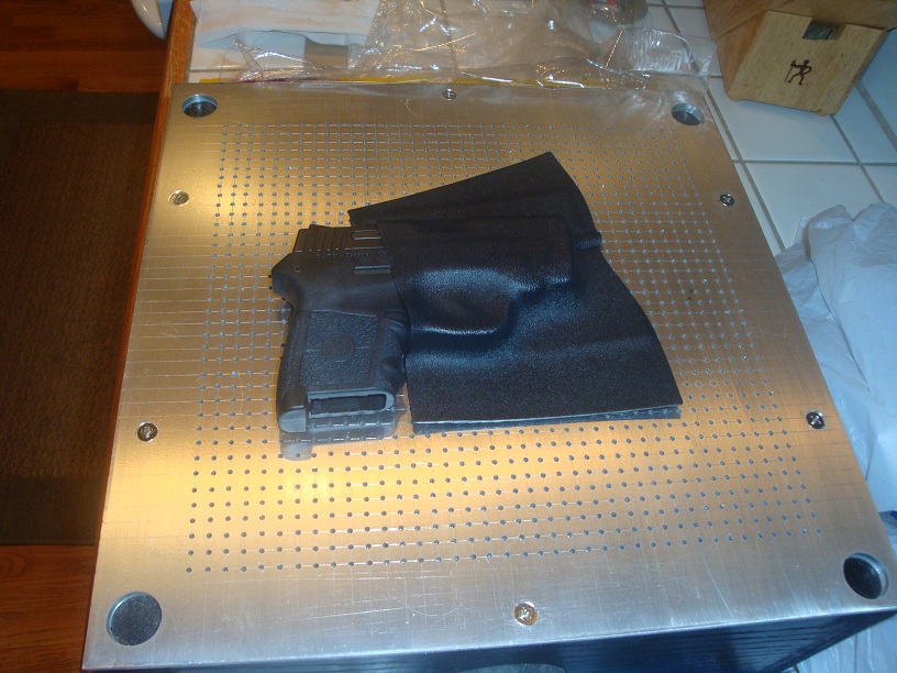

As promised, here are the pics of the vacuum table I made. It is approximately 12 inches square and has roughly 1500 holes 5/64 inch in diameter, drilled 1/4 inch apart. The wooden box is drilled to fit a 2 1/2 inch shop vac hose. In order to pull a good vacuum, cover the hot Kydex with a piece of cloth, then lay Saran Wrap over the whole thing to cover all the holes.
