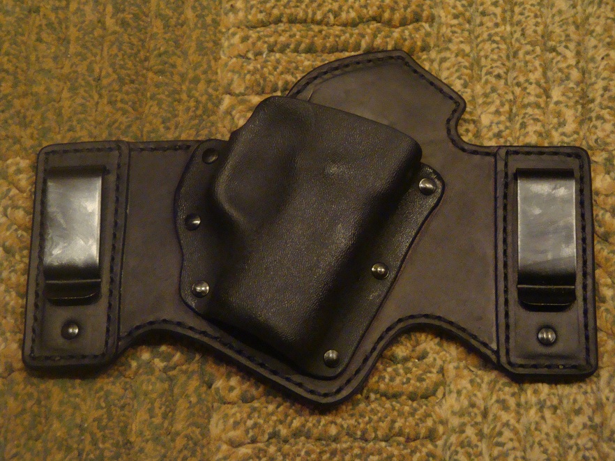

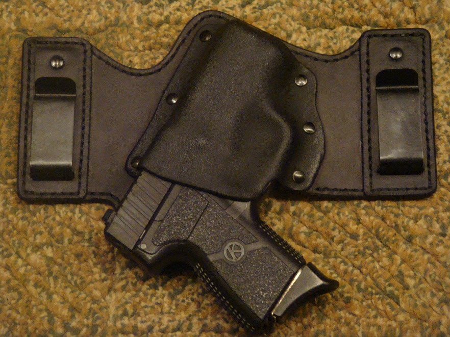

From the album: gun leather
Too much of my profit was going to the manufacturers of the metal clips on the previous model. I had to redesign it some to use different clips. These clips cost less than a dollar each as opposed to five dollars each for the other ones. The back is lined as well.
