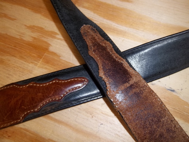

The only leather I have ever used is natural strap veg tanned. I have a belt my wife bought me about 15 years ago that I would like to make a new one of. I'm not not sure how it happened, but I've made it to the last notch on the belt. I don't know what type of leathers are appropriate for making a belt. I know it's hard to tell from the photo what type of leather the existing belt is, but does anyone have a guess? It does not feel or look like veg tanned. What type of leathers are appropriate for making belts? Thanks for your feedback.

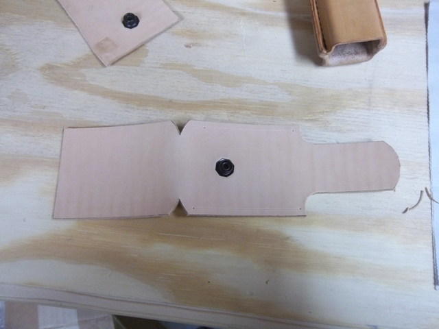

Eric...thanks for the informative posts. Abram...I've only recently started trying to make a magazine pouch also. For me, Glock magazines are some of the toughest because of how thick they are. I haven't been able to get a double magazine pouch figure out, but am pretty happy with the single pouch pictured below. I set the snap for on the back while the leather is flat, fold the leather over, stitch from the top of the curve (on the bottom) to the top opening, then heavily case the leather, force the magazine into the case, fold the belt loop flap to the back, let it dry, then do all the finishing work. I stitch straight lines (don't have to worry about angles for the stitch lines). Eric's quality is much higher than the stuff I put together. I'm more of a rough carpenter, he does the high end finish work. -
I'm trying to make a single magazine pouch for my Glock 17. I'd like to put a snap on the back for the belt loop, so I can take it on and off with the belt in place. I tried two different methods, see attached photos. On the first method I tried stitching two pieces of leather together, wetting the leather, then forced a magazine between them, and then tried to mold around the magazine. I could not get the magazine all the way to the bottom - I should have realized that would happen ahead of time. I also don't want the tabs off on the slide, I want something slimmer. So I tried a second method, molding a piece of cased leather over the magazine, then stitching a piece to the back. I like how it turned out better, but am looking for thought son getting a belt loop on the back and for making the pouch look more professional. The slim pouch in the photos has no finish on it. Any other thoughts on making a magazine pouch would be appreciated.
