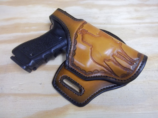

The pattern was taken from Will Ghormley's 1911 pattern pack. I believe on his website he refers to the holster style as the "pancake", but in the pattern pack he calls it the "hugger". I use the same construction methods he lays out in the pattern pack, but modified the back plate and holster to fit my Glock 17. I also made a few adjustments to the design some it was exactly how I wanted it. -

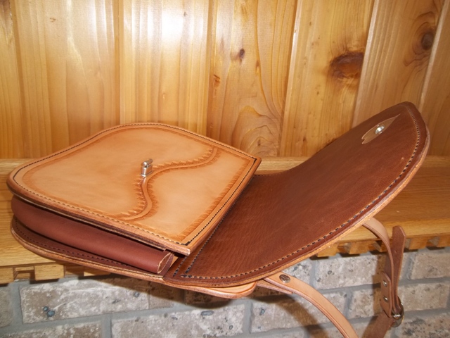

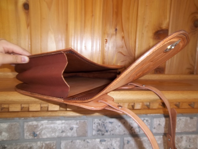

I wasn't sure what to do with the gusset. Do you finish the top edge with a welt? I brought the gusset all the way up to the edge with the lid along the back plate, then cut it off straight leaving it short on the front panel. Should I cut the front panel down some? It looks like I'd only have to cut it down 3/4" or so. Thanks for the feedback.
My first ever attempt at a purse. Thought my wife would enjoy it for her upcoming birthday. The design Bob Klenda's from the the most recent Leather Crafters Journal. I forgot to stitch across the top of the back plate (where the straps attach) prior to stitching on the lid. I could not get my stitching machine into that area once the lid was on. I thought about just hand stitching it, but decided that might make the error more noticeable. I have no idea how to make compartments of put zippers in, so I just left the inside open. It took a lot longer to make than I figured it would, but I was pretty cautious so I wouldn't have to through out a bunch of leather. Any advise for the next one would be appreciated.

The saddlebag style purse Bob Klenda made in the last Leather Crafters and Saddlers Journal looked like something my wife would enjoy for her upcoming birthday. I'd never even thought of making a purse, so I read everything I could on this forum and exchanged a few emails with Kevin at Springfield Leather. I have more hours into this thing than I'd like to admit and one of the mistakes is right on the front of the bag for everyone to see. Yep, I forgot to stitch across the top of the back plate (where the shoulder straps attach) prior to stitching the lid to the back plate. I could no longer get my Cobra Class 4 into the area to stitch it. I though of just hand stitching it, but thought that might be more noticeable than not stitching it at all. If the seam does not hold up, it'll be another lesson learned. I didn't sew any pockets or compartments into the purse. I wasn't sure how to go about that. Any feedback or suggestions would be great.

Mike....here's a photo of the back. The back plate has a curve in it so the magazine release is accessible and so you can easily grip the firearm. The first few holsters I made in this style were cut straight across the back plate, which made the firearm difficult to grip and covered the magazine release. -

With this holster the Glock 17's muzzle protrudes beyond the end of the holster. The Glock 19 sits right at the bottom of the holster body. I haven't had anyone request that I extend the body down to cover the muzzle, but I have cut a few shorter for the Glock 26. I wear a 17 almost daily in this same model holster. -
